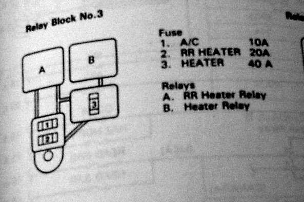

pics!
J,
Here are 2 pics showing the relevant info from the service manual. Of course, it doesn't mention how to get to it - but I think if you take off the lower valance/glovebox stuff, you can get to it.
Good luck!
Good luck!
