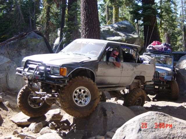

I have an 88 Runner,, with a straight axle ,,I opted for a 3/4 ton Dana 44 front axle out of a 78 Chevy,, I narrowed the longside 2.25"s an able to run a stockFord F-150 longside axle (no custom axles),, I have the spring pad width the same as a stock Toyota 4wd front axle 79-85,, I run 5,5" lift Alcan springs, with the centerbolt moved forward 1.5"s,, I made my own front crossmember,, (which is a complete bolt-on unit),,
Attached Thumbnails Any one out there own a straight axel conversion 4Runner????-webiltbarretta2.jpg
