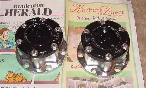

Old Mar 18, 2003 | 12:56 PM
metal22lica's Avatar
Joined: Oct 2002
Posts: 992
From: Bradenton, Florida
From:
TO:
aww.....arent they cute? now..time to work on the rig!
the pic is the attachment so no need to download it.
Old Mar 18, 2003 | 12:57 PM
delboy's Avatar
Joined: Feb 2003
Posts: 316
From: Ireland
They look in really good condition.
Old Mar 18, 2003 | 04:56 PM
4x4CPOSEADOG's Avatar
Joined: Feb 2003
Posts: 425
From: On the right coast
Hokiez97 said it all. Hey Metal, those hubs really looking great. They are the reflection of Victor's hubs.
I bet you are having fun with these hubs. Congratulations!
Noel

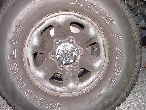

Old Mar 18, 2003 | 05:01 PM
Joined: Oct 2002
Posts: 992
all done guys..check it out!! its hard to see..but you get the pic!!
Old Mar 18, 2003 | 05:47 PM
Victor's Avatar
Joined: Jan 2003
Posts: 1,705
From: El Paso, TX
Looking good.
Old Mar 19, 2003 | 08:41 AM
Hokiez97's Avatar
Joined: Jan 2003
Posts: 141
From: Waynesboro, VA
I don't see any hubs......
Hey Metal,
I don't see any hubs...... I see black plastic caps with stainless bolt glued to them.......
HAHAHAHAH
Actually I may paint mine black this spring. They look pretty darn good.... My wife will problebly tell me to paint it some other color though.. :frown:
I am planning on getting a hole saw and fitting my black plasic caps back over the body like 4x4CPOSEADOG................
Good job!!!
How many miles on the Michelins?
Mike
Old Mar 19, 2003 | 10:49 PM
Joined: Oct 2002
Posts: 992
shh...dont tell anyone but that is glued to the top of my ADD cover! im not sure how many miles on those tires..i bought the truck and the guy said they were new. i have put 15000 miles on them.
