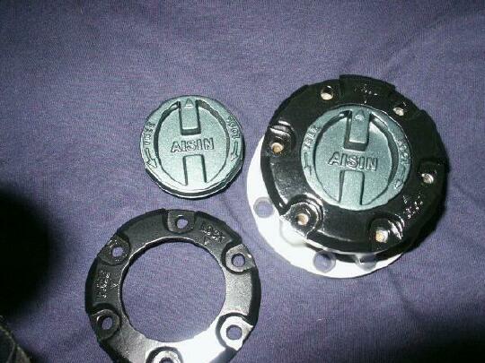

I finally got the paint from the dealer today. The dials match the color of the truck. I will be installing the hubs sometime this week.

Nice, not far behind you in the conversion. I am waiting on some $$$ so I can get the 54mm nuts and washers so mine can go on.

hot....nice job on the paint!!

Looks good Sludge! I'm curious to see how they hold up to our winters.

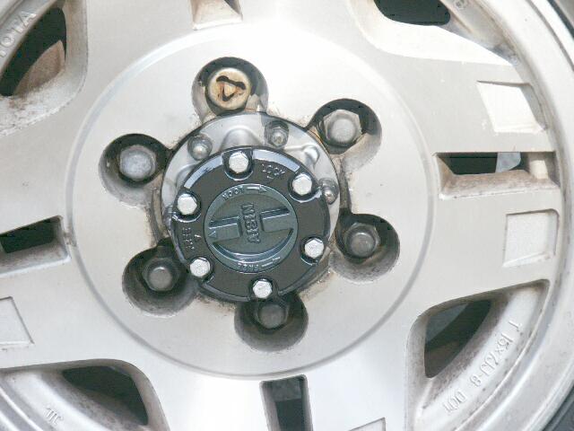

HUBS ARE INSTALLED
Took me about 1hr to do and super easy. Went on a test drive around the block and i could feel the difference. I can feel it in the acceleration and even in breaking.Almost like im not towing an anchor behind me

Looks good Sludge.
