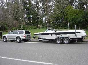

What year model 4runner has the "jounce" bumper in the springs? I have a 2000 Limited, and have decided on the Airlift 1000 Outback special package (bags with onboard compressor/regulator)... am trying to figure out whether I should go at this myself, or hire somebody to install the kit.
Have a lot of experience with stereo/electrical, but NONE with suspension...and am worried I could get in over my head.
Any advice is greatly appreciated!

Anybody have any advice on how difficult it is to remove the springs, etc, for the install of the air bags...for a novice like myself? If all I need is wrenches, drills, zip-tyes, and maybe a spring compressor...than I think I've got it covered...otherwise, I think I'm gonna have to hire somebody (never touched suspension...just stereos and electrical). Either way, I just ordered the AirLift Outback special package, so I guess I'm committed...
I've attatched a pic, so y'all can see my problem!
Any help: greatly appreciated. Thanks.

I wouldn't be using the bags all the time, just when towing... that's why I settled on bags, because they're adjustable. I really don't want to touch the stock suspension any more than I have to. Thanks for the ideas though!
