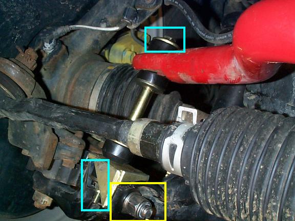

manymods, i have a 2001 Runner and think i am having some of the issues stated in this thread. i hope u don't mind i copied 1 of ur pics and circled a couple of things that i know i am experiencing. i hope someone can help.
the bolt circled in yellow - i can not keep tight. i've tried lock washers, lock-tite, etc. any ideas? what size bolts are u using?
the bolts cirlced in blue - what torque rating did u use? did u just crank down on them as hard as possible?
also, u talked of elongating the forward mounting holes. any chance of getting a pic and circling the area mentioned. i tried looking thru the pics u currently have posted, but i couldn't really see much.
thanks in advance,
brian

I am still away from home so I cannot give answers to everything; however, ...
1) CHRIS: The front endlinks and bushing brackets are functioning well from what I can sense from the driving position but I will get underneith again when I get home for one more look. When we did the coil-overs everything was tight with no stress cracks, shifting or bends and I have been pushing the envelope since the springs went in.
2) BRIAN: Call Addco and tell them you want the endlinks. I expect that they made additional sets but the bottom line is ... first come first served. I used Nyloc nuts and cranked down on them as hard as I could. They are stainless and I would be very surprised if one of us could break them by hand without a 24" - 36" breaker bar. As for the endlinks, I did this by feel. You want them tight to the point where the donut bushings start to bulge but do not totally distort.
3) PHOSHO: You should use some sort of Moly lube or graphite lube.

Amended response
Brian ...
I looked at that picture again and it looks like I also used a split washer in conjunction with the Nyloc nut.

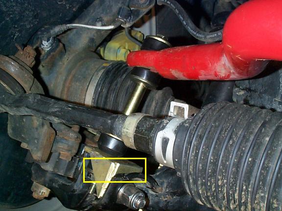

manymods, i just crawled under my Runner and noticed that this bracket (see attached) is cracked. plus, i don't think my bracket looks anything like yours. where did u get yours from?
Attached Thumbnails ADDCO Front Anti-Sway Bar Problem-addco-end-link-installation-31jan04-008_a.jpg
Yours is the old style and they have made them a lot stronger now. Call Addco and tell them you have their old brackets and they cracked. They should send you new ones at no charge.
