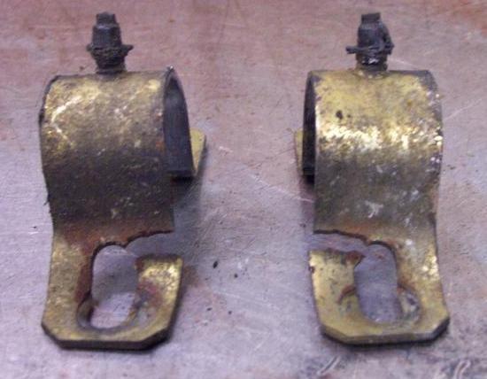

Question ADDCO Front Anti-Sway Bar Problem
This thread should only be of interest to those who have ADDCO bars.
It has been about a year since I installed the Addco bars, using the OEM ball socket end links and ES greaseable bar brackets. Yesterday when we dropped the bar to access the tranny pan for the valve body recalibration, I noticed that both clamps were cracked --- and cracked in identical locations! I cannot figure out what it is that is stressing the clamps to this degree. Is it the end links or the ES clamps? Is it the mounting locations on the frame? Is it when the suspension is fully suspended? Has anyone else had this problem. Take a look at the attached picture and LMK if you have any idea.

Looks like those brackets arent heavy enough in relation to the size of the sway bar. Those brackets are taking a huge amount of stress when one side of the vehicle is at full droop or compression. So the sway bar is trying to rip those brackets off and that point is the weakest link.

The addco swaybar is so stiff in comparison to the stock swaybar, and I've found my brackets also have bent, but not broke. It's great for on-road, but you definitely don't want to take it off-road or any articulation situation with the bar connected, because it will eventually, as you've experienced, break the connectors at the frame. They are weak, that's for sure!

I just got my quick disconnects today, while installing them I noticed both of my clamps are cracked in exactly the same manner as your picture. I had stock swaybar on, with no disconnects. I think mine broke due to the articulation I subject mine to. They broke in exactly the same spot on both because it seems to be a scored casting mark or something.
Is this something that needs to be replaced? How is this dangerous, the endlinks are still attached, even if it broke completely off.

The problem is that we really need thicker brackets, which would mean that the bushing thickness would need to be thinner that what we are using now but the same inner diameter of course. The location of the brackets on the frame could be changed, but not easily. I would just fab up your own brackets out of 1/8" or if you can find the right bushing, I'd do it out of 3/16".

How is this dangerous? Imagine that the front part of the bracket broke completely loose and then the stress caused the bracket to bend enough to allow the bushing to separate from the bracket. The bar _could_ drop down and then I cannot imagine what would happen next. I also think that if the bar started to float it could twist the endlinks in such a way as to damage them.
I think it is interesting that someone with a stock bar is having the same problem; however, what I want to know is whether someone who has the Addco bar and the Addco endlinks and bushings is having the same problem. To me this could be the real tell tale.
I was also thinking that an easy way to reinforce these weak points is to fabricate what amounts to a large square washer that fits directly on top of the slotted attachment points on the bracket. This would amount to doubling up on the part of the bracket that does _not_ go over the bar holding the bushing. The more that I think about this the more I think that this is all caused by the fact that the Addco bar is so thick that the bracket mounting holes in the frame are too close together to accomodate the new brackets. The other part of the equation may be the longer (OEM) endlinks, although it is usually the shorter links that increase the tension of a bar.

Last time I lubed the bushings I did not notice any issues at all with my brackets or links. I've had the Addcos installed for three years now. I will try to check tomorrow for any cracks in the brackets but we have a lot of snow here so I may not be able to get to it.
I am already using large outside diameter washers on the brackets to more evenly spread the load. At first I used normal washers but noticed that even with the nylock nuts the bolts would loosen up. I believe that the regular sized washers or those supplied with the ES brackets were not seating well enough and perhaps the brackets were moving around ever so sightly. In my case I caught the problem early enough and put on large outside diameter washers with two nylock nuts. Maybe in your case the bracket had a gotten little play in it and the movement tore apart the bracket over time?

James is one who believes in over engineering his installation IMHO, for one thing, if you used the shorter endlinks you would be creating more tension on the sway bar, making them even stiffer. It is my belief that the mounting holes are spaced too close together to provide the correct purchase for the required span needed for the thicker bar brackets. Therefore, if the bracket does not have some reinforcement at the point where the bolt is closest to the beginning of the bend in the yoke it is likely to break. I also think that the balljoint design of the OE endlinks is not sturdy enough to handle the added stress imposed by the stiffer bar --- which is a 400% increase. I have no problem with my rear bar but am considering changing over to the Addco front endlinks as well as seeing if I can drill another hole in the mounting surface (if there is room) to provide the correct span for the larger mouning bracket. As it is, the endlink is canted off-center from what should be a vertical line perpendicular to level ground. If this cannot be corrected then it would imply that the bar is too long. The mounting bracket straps have slotted openings to provide for lateral adjustment in order to maintain the vertical line. I hope this makes sense.
I think, for the sake of your peace of mind, if you use really large fender washers and maybe double up on them because they are usually thin, you should be all right. I make no claims as to what is right or wrong, this is just my opinion and you must use your own judgement in the end to assure your own personal safety.

You do not need to double up (lock nuts) but you should use Nyloc nuts and at least a 1-1/2" fender washer. If you cannot get thick fender washers, then double up on them. BUT, this is just a bandaid and what we really need to do is ascertain where and why this is occuring. It is happening for a reason and it is clearly not right. When the weather improves around here (sometime in July) I will get under the truck and see what I can figure out, but with the suspension fully extended we had to use a pry bar in order to get the swaybar / brackets back into alignment position over the attachment holes in the frame. I maintain that the endlinks are too long, but we will see.
