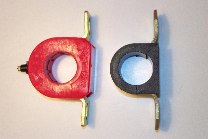

Okay, you guys have seen the broken front sway bar bushing bracketson my 4Runner. Well, one of them has completely broken and is relying on the remaining mounting point for support. I want to say that I am not a city mouse like James, nor am I a rock climbing mud runner like some of you banzai boys, but I do travel on a lot of dirt roads --- even though I do it gingerly.
It is time to revise James’s (jalaber) installation instructions. Take a look at the attachment that compares the Addco front 1.25 non-greaseable bushing/bracket to the greaseable one I just got from ES. I’d like the engineers here to follow me on my logic. The front end gets the most stress on a day-to-day basis. From the attached photo you might deduce that the Addco strap stock is thicker than the ES strap stock, but they are really the same thickness --- actually the ES is just a hair thicker, but we will call it 1/8” (3mm). The big difference is the way the bracket strap is engineered and the thickness of the Polyurethane bushing. The ES bracket strap has about 5/8” of flat strap surface and then the sides are flared out about 1/4”. The bushing protrudes from either side about 3/16”, the same as on the Addco bushing bracket. I think there is more cushioning on the ES bushing bracket and that translates to more shock cushioning and less stress. I also think the ES bushing bracket design allows for more chasis flex. But the big difference is that the strap is thicker than the ES one we are using This new bushing set is made for “trucks”. I checked the mounting pillow bolt hole span and from center to center it is 3”. I think that means that we might (?) have to elongate the slots on the ES bracket but I am not positive. The specs show that the bracket will mount on a 3” span.
The part number you need to order is Energy Suspension PN 9.5172 (1-1/4” / 31.5mm). Unfortunately, ES does not make a HD bushing set for the rear 1" bar so we will continue to use the 9.5161 greaseable set as specified in James’s write-up, or use Addco's bushing set. I also want to add that I am going to change out the OE Toyota end links, especially in the front where we had to use the thinner pancake bushings, and install the Addco adapter brackets and end links. I never liked the idea of those thin bushings anyway. Are there any comments?
Attached Thumbnails ADDCO Front Anti-Sway Bar Problem-es-9.5172-vs-addco-1.25-inch.jpg

looks to me like you might be able to double up on those brackets. The bracket for the smaller sway bar could possibly fit over the other with some persuasion.
Old Jan 28, 2004 | 04:55 PM
  #40
ManyMods's Avatar
Joined: Jan 2003
Posts: 840
From: Martha's Vineyard Island, MA
Man, I am sorry but I just do not know what you are saying, and I guess I do not get the point.
The mounting bolt hole points for the rear bar are 2-1/2" center-to-center.
