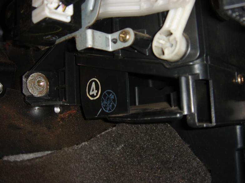

I have all the lower vents closed. But see the open space next the the 4 in a circle? Cold air blows out of that to the point on a long drive my right foot is freezing. This is to the right of the gas pedal. Does anyone else have this opening? I was thinking of just blocking it up. Maybe get some more cold air coming out of the vents also.

I have the same opening and to me it sounds like there is a vacuum line off.
if you use a piece of foam or something that would probably work. I would guess .....

Yeah, but why all of a sudden? I've had this truck for almost ten years now.

vacuum lines get brittle and break.

Do you have the automatic (digital) or manual A/C control? If its the automatic, your A/C mix servo may have gone out. If manual, the mix control cable may have problems. Both can just happen with age. That opening is the normal floor discharge. There is an amazing diagnostic routine for the auto A/C in the FSM--the thing can diagnose itself.

I have the manual. Old fashioned dial you have to turn with your hand. LOL

that hole leads to a "vent" that comes out at about knee level directly below the steering column
