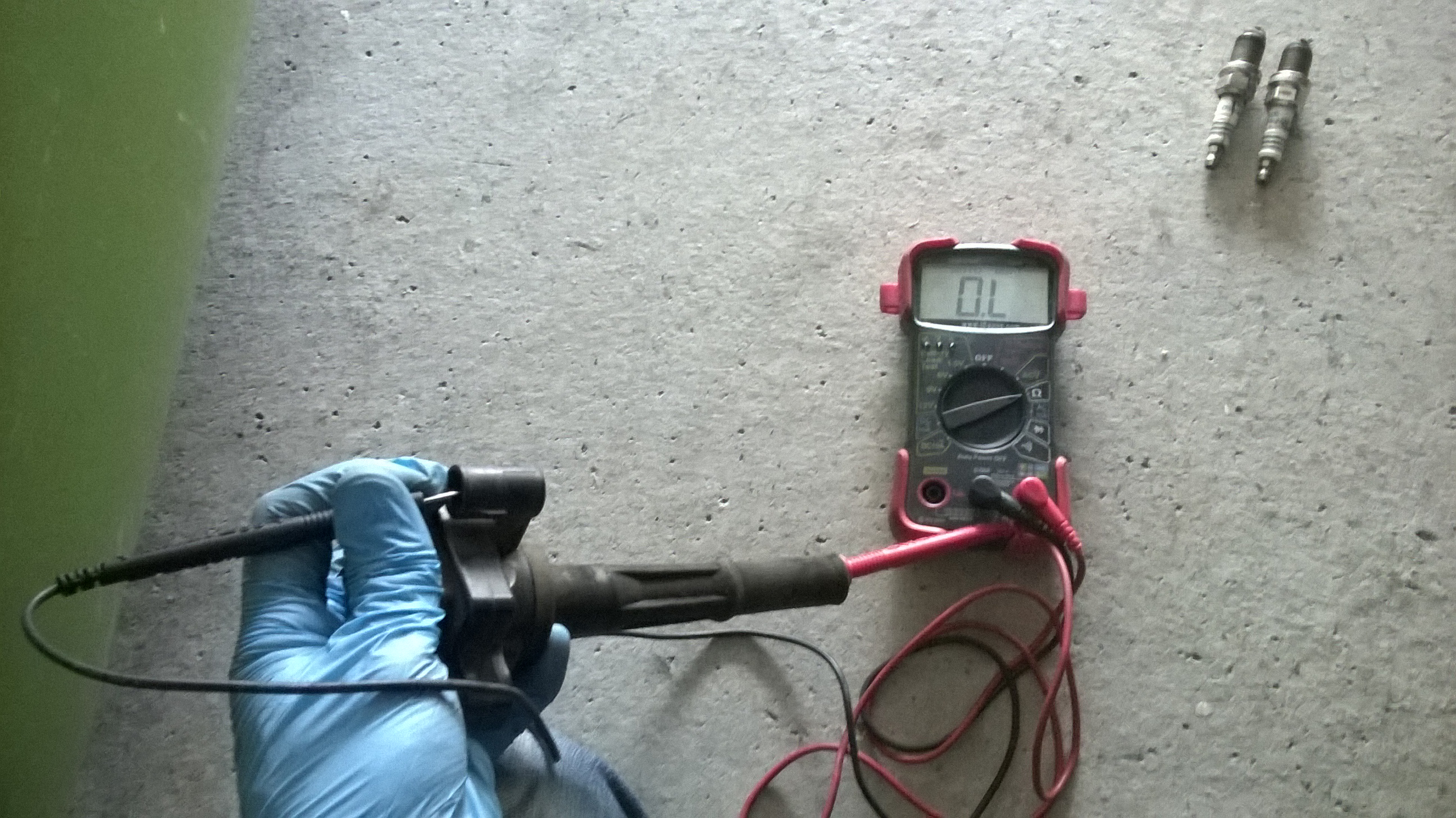

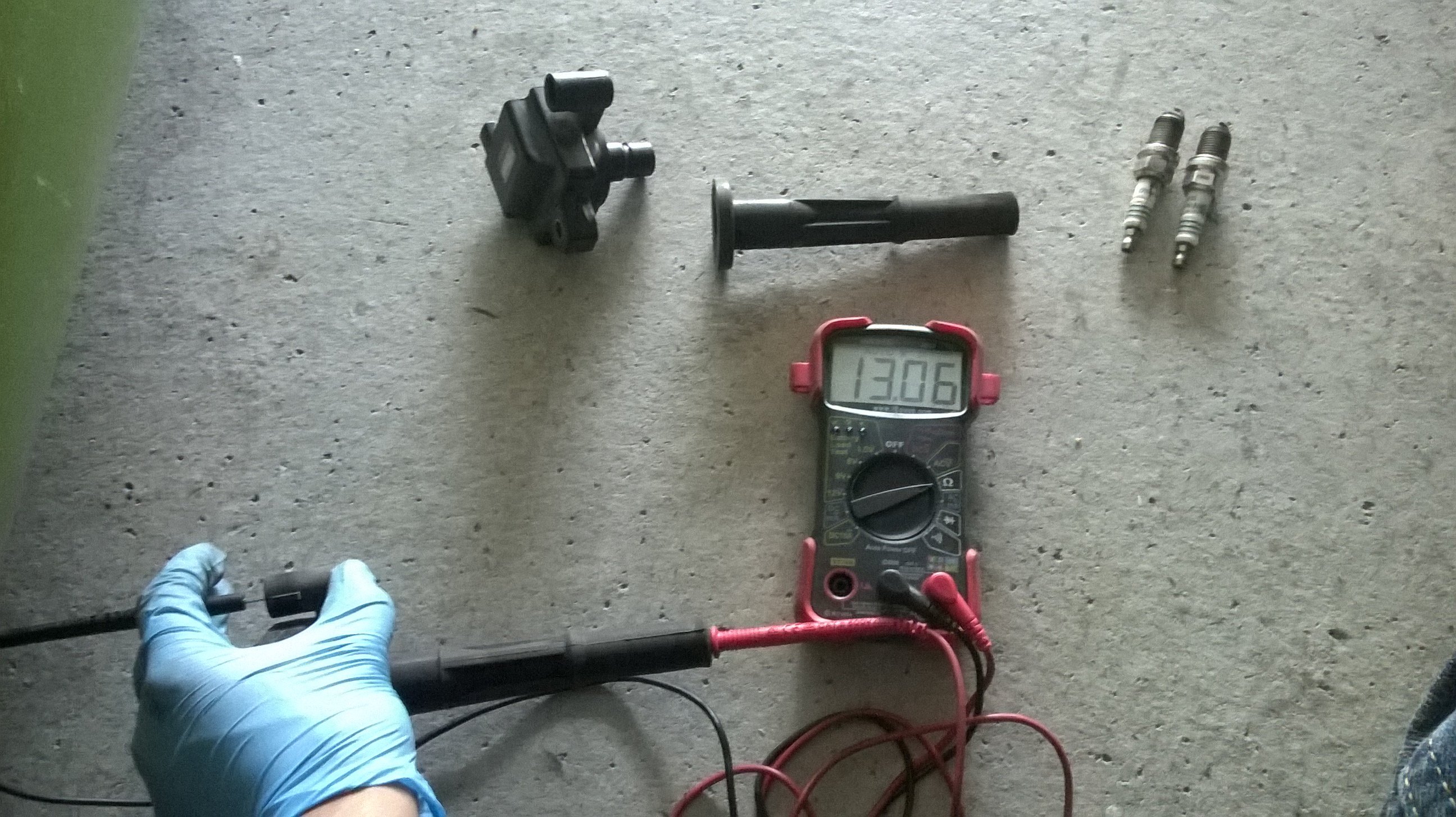

I thought maybe my injectors are going bad...but I checked resistance on #3 and a good one and mine are ok. I disconnected mine while the engine was running and both gave me indications they weren't shot yet...

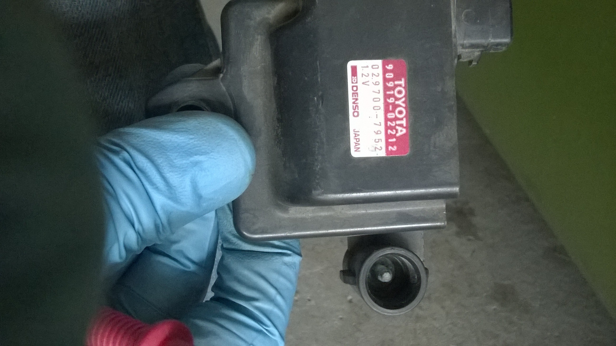

So I checked coil packs and forgot about the corroded one for cyl #1 and 4. Pic shows where. Resistance was flat.
Another coil pack was on its way too, but I managed to salvage it by switching the coil boot off the bad one onto it and the resistance stayed solid with specs. This pack was getting weak. That p0300 can mean any cyl.

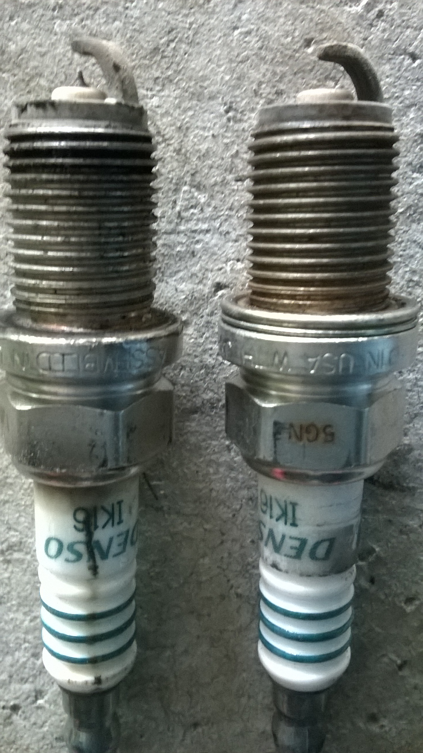

Check out my 'still new' plugs from cyl 3 and 6. Guess which code that one was responsible for? I put in those plugs less than 4-5 yrs ago. Dont drive much annually. Hmmm.
May need to recheck stuff you initially thought was good.
