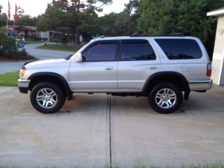

I have a 97 2wd with 99 tall springs and KYB shocks on all 4 corners. Since this thread was so old I'm not sure if anyone will care but this is what it looks like, raised my truck about 2 inches evenly and made my Tundra wheels look better. I'm not a hard core wheeler, driving on the beach is about as "off road" as I get, but I had to replace everything anyhow (old stuff had 152k), so I figured why not. I am thrilled with the end result. Hope this helps. Heres a before and after:

@dgoll75, looks good.
I was just thinking about adding in the tallboys (or LC80s), though as far as I can tell from the forums the 02 springs were decently tall to begin with... The concern I am now having is whether or not the truck will fit into my garage if I do that. I am replacing my 265/70-16s with 265/75-16s soon, which will add ride height. Add that to the fact that I am sporting a safari rack on the top, and you start getting really close to giving it a haircut on the way in... Eek.
