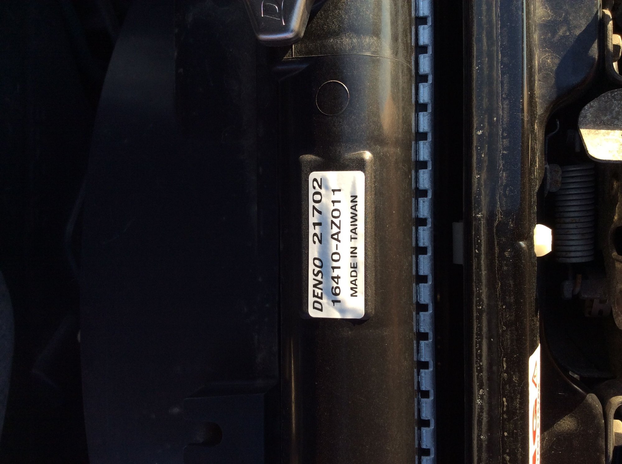

I have to admit, I was disappointed that Summit sent me the China version of the Denso 221 radiator. I have bought many items from them in the past and been happy. I know they want to put out the best price possible, but come on, why not the best price with the best products? Okay, done with my rant! Living where I do, is Four true seasons, cold winters with lots of snow, hot summers with 2 months of 90s-100s temps. I live at about the 2000’ level. Then loaded down with camping and off-road gear, I wanted to make sure the runner will be as dependable as I can with good maintenance and Toyota or better parts when I replace or repair anything. Still have the factory bumpers and running boards. But that will be changed out as money is available. Maintenance first, buying a used vehicle I went through items to insure a dependable vehicle. Next up, timing belts and water pump, then transmission flush and transmission temperature gage. Then Factory running boards will come off and good rock sliders, for rocker protection. Bumpers after that. Staying with stock size tires and no lift for now. Want to have my full plan on the build before adding bumpers and more. Even for now, will go with bolt on rock sliders tell I decide on lift for my intended use.
I traded in a 2010 Jeep JK Rubicon, for this 99’ 4Runner. The Jeep had low miles, but with my health issues, road to stiff and was beating me up when even going up my dirt road to my property. I have a Jeep Cherokee, with a diesel Mercedes Benz 5cylinder motor with lots of other work and mods done to it. Will be selling that if I can get most of my money back out of it. Also, a 99’ Dodge 2500 Cummings 4x4, that I use for truck things and hauling my 10’ Alaskan pop top camper. The camper is old, 1965, but in great shape. Have myself spread out a little to much, so, Jeep will have to go! I have had 5 Toyota’s in the Pass, so, New what I wanted this time around. Glad to be on this forum and hope to help others and learn all I can too. Thanks everyone for helping with my questions! Vance.

Here is the radiator you want! $164.00 from my local dealership. Been in now about a month and 2000 miles later over ruff roads, some of the miles are from my trip on the WABDR. I did also add the BM transmission cooler in series, radiator- BM cooler- then back to transmission.
