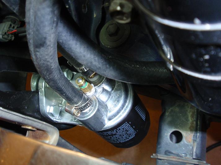

If you do put a spin on oil filter get a mount that will allow you to put a temperature sender on there. Kill two birds with one stone
External trans cooler questions and people who bypassed the radiator get in here!-4r-filter-top-front.jpg
You can see the sender in the center of the filter mount. I didn't have the wire hooked up yet when I took the photo.

john4r where did u get that filter bracket that had the place for the sending unit
Summit Racing, here is a link.
http://www.summitracing.com/parts/PRM-10677/
I got the kit that included the gauge. Part number prm-10677, you can get it without gauge but I don't have the part number.
It can probably be had a little cheaper than Summit but they have fast shipping and good customer service.
