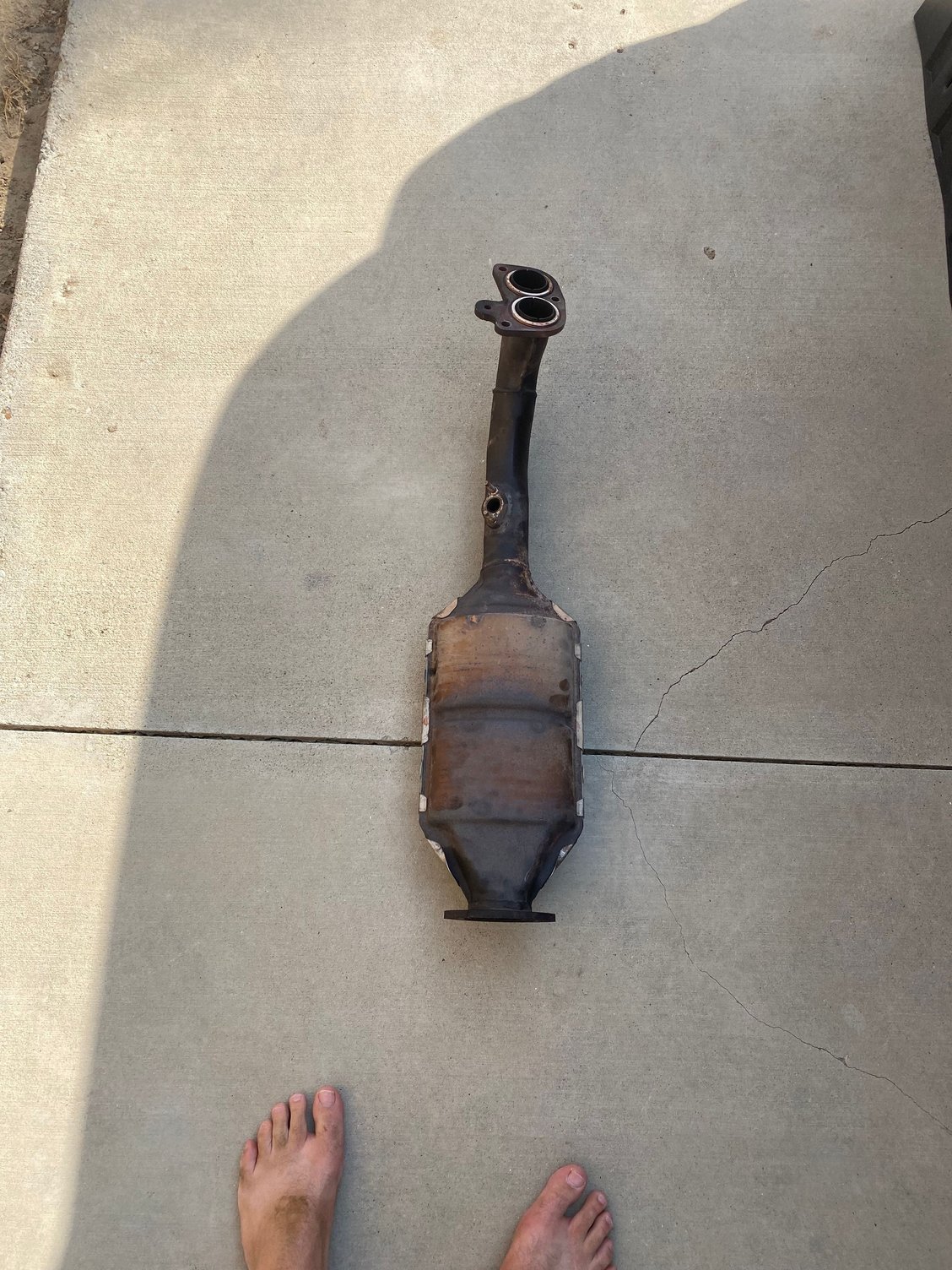

my issue now is thus centralized metallic rattling that centers around the shifter to the passenger footwell side. 9 times out of 10 I can do my 10 mile commute round trip without triggering it, but if I stop really hard or hit a substantial speed bump/pothole, than the rattle begins. It’s amplitude seems to match the RPM of the driveshaft, and it’ll increase or decrease with the vehicles speed. It’ll will eventually stop with a climactic clank and then will be silent til jostled again.
I’ve bounced from checking every heat shield underneath and couldn’t find anything near the spot I hear it at that was loose.

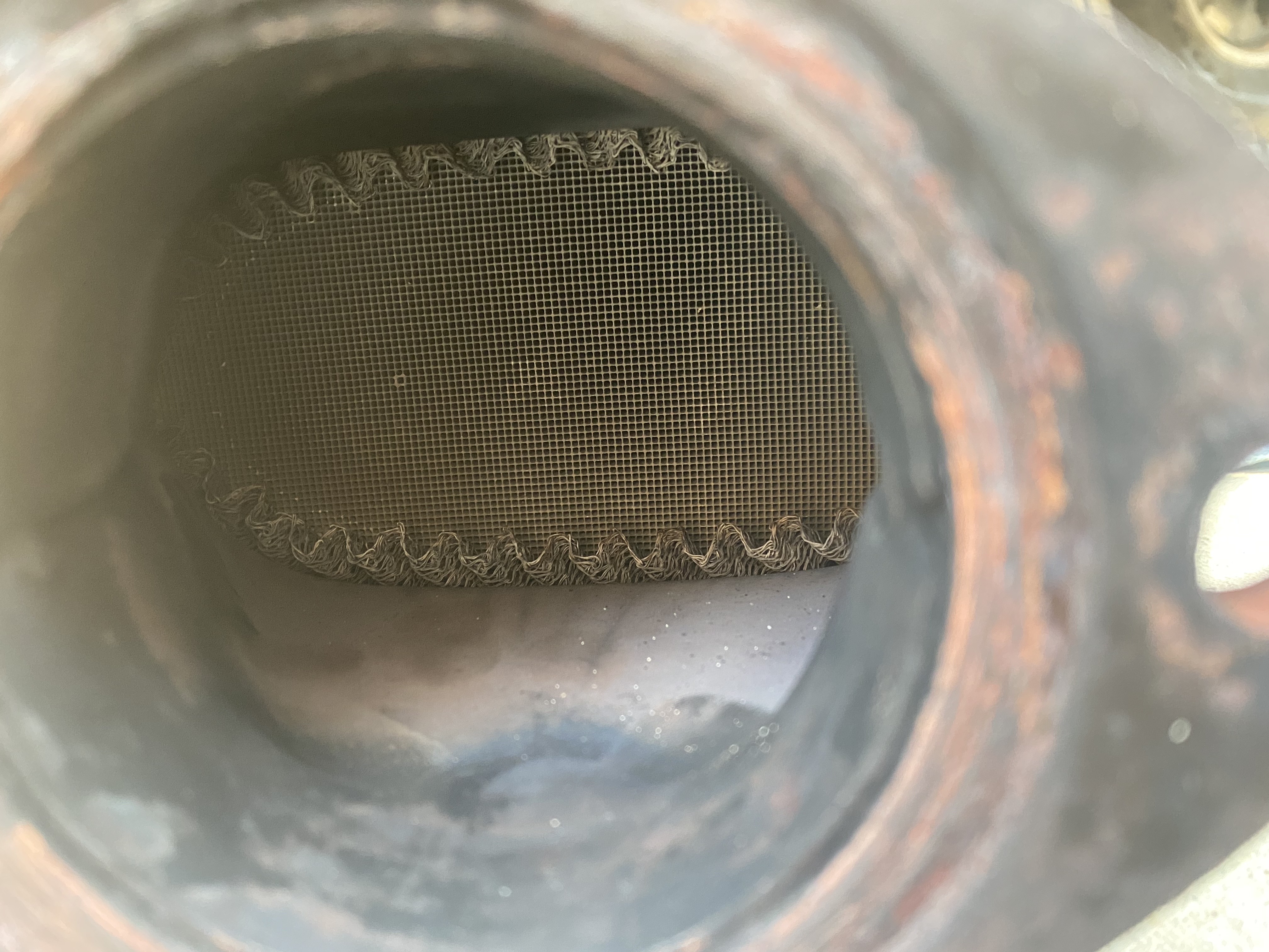

Today I re-attacked the issue and removed the cat/front half of the exhaust attached at the manifold. My hunch was that there was a baffle loose in the cat but I took it off and shook it and nothing was loose….
my relatively amateur eye couldn’t find anything visually wrong with the driveline either….
attached are the link to the video of my noise, photo of the inside of the cat, and my current troubleshooting setup.
All advice welcomed!

Couldn’t find any points of contact underneath it and put the cat back on because it clearly didn’t have any loose internals… Not sure what else I can do from home so it might be time to send her in to a shop that can peel it open to look at the torque converter.

Sorry for not completing the circle here gents!
I left on a 2 week work trip, the wife couldn’t take it anymore and took it in… Turns out *Drum roll*
it was a loose metal seal on the steering column that had sheared off at some point between now and -99. $60 for them to peel it open and take it off.
it was super benign and I was infinitely surprised at how little of an issue it was
