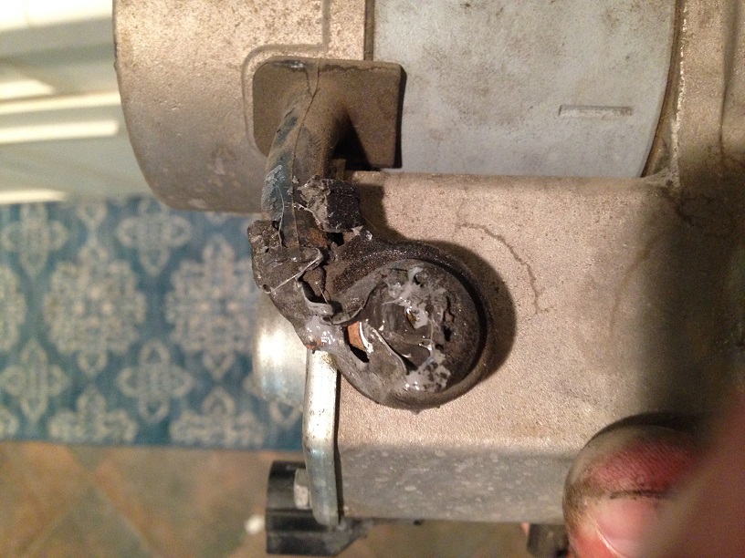

I replaced the starter contacts and plunger. It seems to be starting on the first try...for now.
Something interesting though. When I pulled the starter, the rubber cover for the wire coming from the yoke was melted badly. I attached a picture. Any reason for this?
