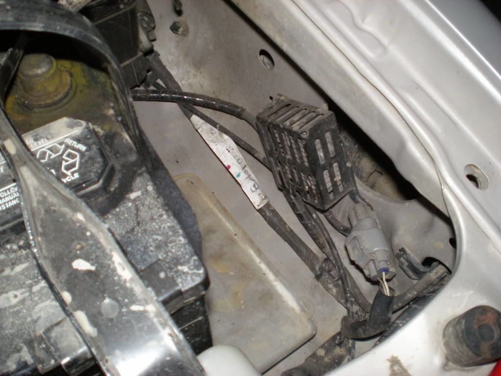

DRL's would use the low beam filament, try unplugging the DRL relay under the hood near the battery, do you have tail lights and marker lights since you have interior lights?. Is it a Limited or an SR5, do you have fog lights.

UPDATE: Checked bulbs and they're fine. I could not find the DLR (daytime running lamp) relay that was referenced earlier?

Undue this plug to disable DRL's, this should rule out the DRL dimmer under the dash aswell,.. but I'm wondering if there isn't a problem in the fuse box under the hood or battery connections, maybe do a clean up and check for corrosion in the fuse panel, do you live in the rust belt. I hope you changed the bulbs well you where in there sometimes its hard to tell they are blown.

Is this a Canadian Runner? '98s did not have DRL's in the US. And I've never seen a DRL with two fuses; the US 2000+ DRL's have four. Are you sure it has DRL's? It makes a HUGE difference to how we troubleshoot, since DRL's are hot switched and non-DRL's are ground switched, so we need to know for sure.
