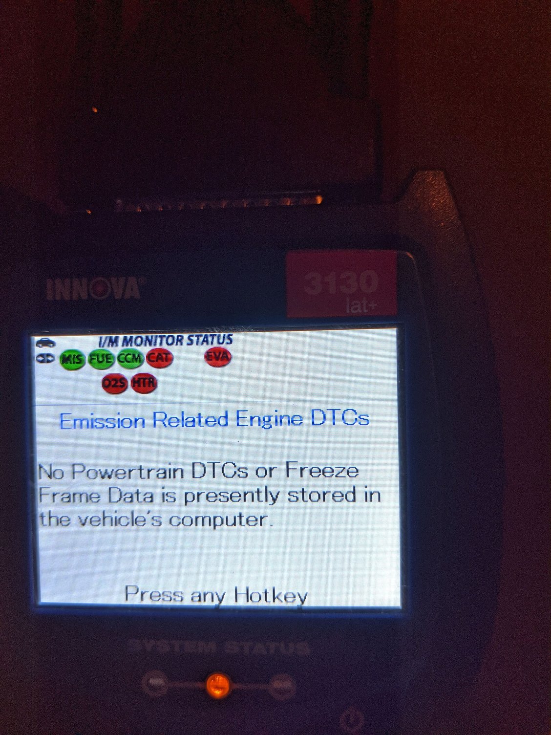

Replaced the valve cover gaskets, half moons, camshaft plugs, spark plugs, plenum gaskets, and throttle body gasket. Put everything back together and started it up. It started then began to choke then died. Now it won't start at all. I labeled all the hoses and wires and reconnected them to the correct locations but clearly I screwed something up. Any ideas?
The OBD II sensor doesn't throw any codes but reads this:
