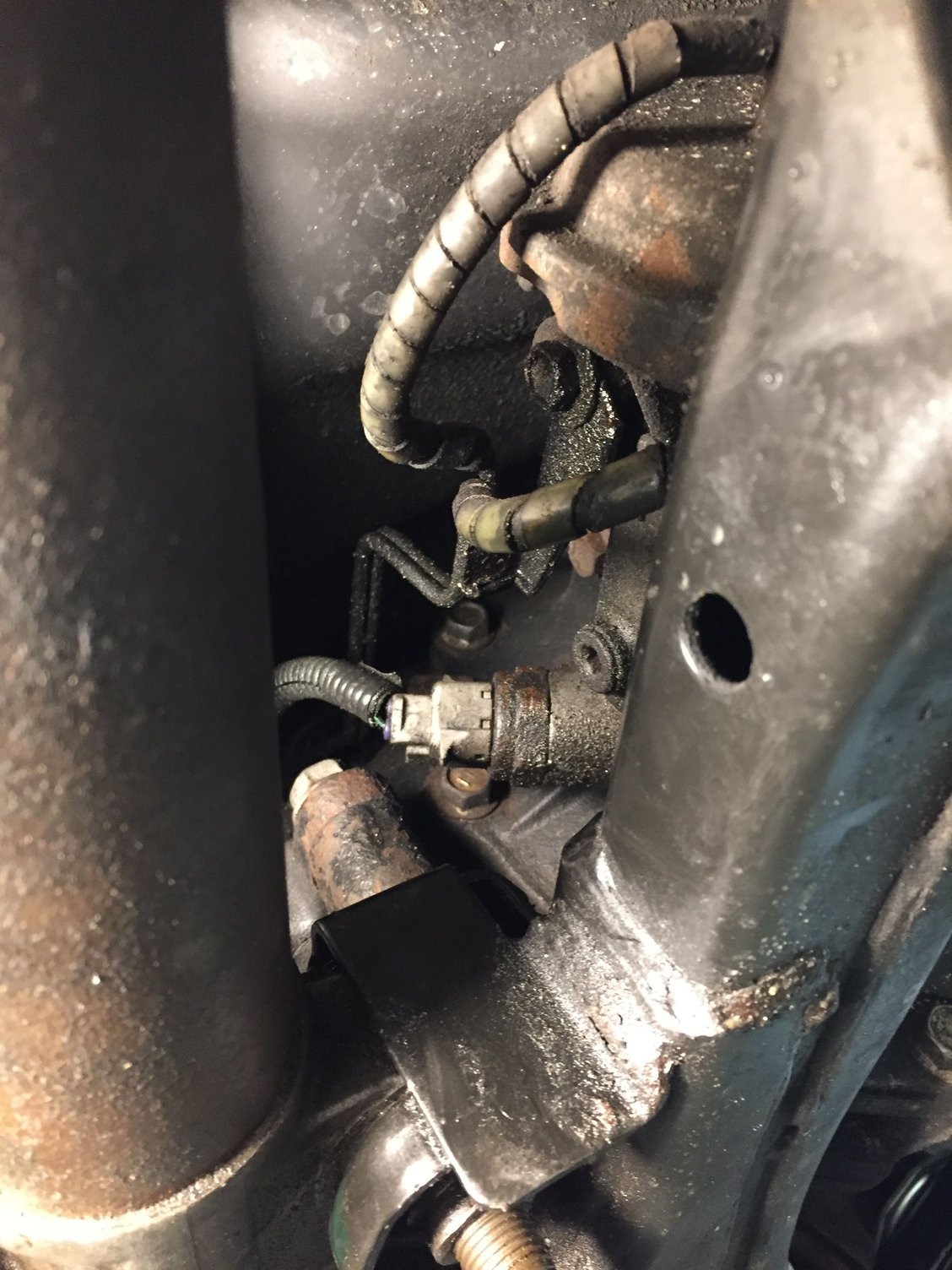

Here is the issue I had with my 4WD... Every so often I would engage the 4WD to give it a little exercise. At about 200k miles I started noticing a delayed response from the 4WD. This wasn't an issue until one day when it would not disengage. At first I thought it might be a vacuum line, but I could not find any leak. Eventually I found a thread describing a similar issue with a 4WD position sensor. The sensor is located on the back of the front differential. Oil from a leaking valve cover gasket had run down the engine and caused the position sensor to fail. I removed the sensor and gave it a good cleaning with break parts cleaner and it solved the problem. Hope this helps!
