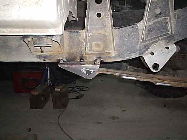

Here in Chile it is very common to put 63 inch Chevy springs on the Hilux to gain wheel travel (flex) and improve the on road ride (less bouncy)
It is a very simple swap, you just have to reposition the leaf mounts, something similar to this (see attachment):

Originally Posted by dwh91102
88-98 chevy or gmc 1/2 ton pick up
more than you ever wanted to know about chevy spring swap right here
I would also like to thank silvertruck for helping me out
Nice write up!
