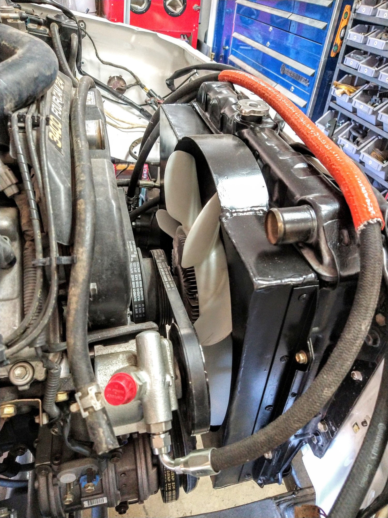

A fan shroud is a must have in my opinion. Will your shroud work with a 3.0 fan? I know the 3.0 fan fits the 3.4 fan clutch because that's what I'm running. I did a 22RE to 3.4 swap and I'm running the same 3 row brass radiator for my 22RE in my 88 pickup. I had to fabricate my shroud. I'm in AZ and mine doesn't run hot. It did start to creep up in temp ONLY above 65 MPH and I found it was my winch and bumper blocking air flow at high speeds. I modified the bumper and that fixed it.
IDK if the jiggle valve position really affects the temp. I always "assumed" it should be positioned up at 12:00 and ran it there for many years without problems. I recently found out it's supposed to be at the bottom at 6:00 and installed my new T-stat there. I haven't run it yet because my engine is going in my current build that is not quite finished.
If your radiator is clean my guess is you have an air flow problem across the radiator. Maybe a GOOD electric fan setup would help. I personally never had good cooling with electric fans but I haven't tried any of the newer ones. My 22RE radiator with shroud and 3.0 fan cools my 3.4 here in the desert so I would think your larger radiator should too. I also had my radiator rodded out. It is pretty old though.
Since I don't see freezing temps here, I run a 60/40 coolant ratio most of the time but I haven't run hot even with 50/50. I'm running the old school green coolant since I have a brass radiator and heater core and tubes. Back when I did the swap the Toyota red coolant specs said it didn't protect brass. IDK if that is still the case today. I've been running the green since my swap and I think it was back in 2011.

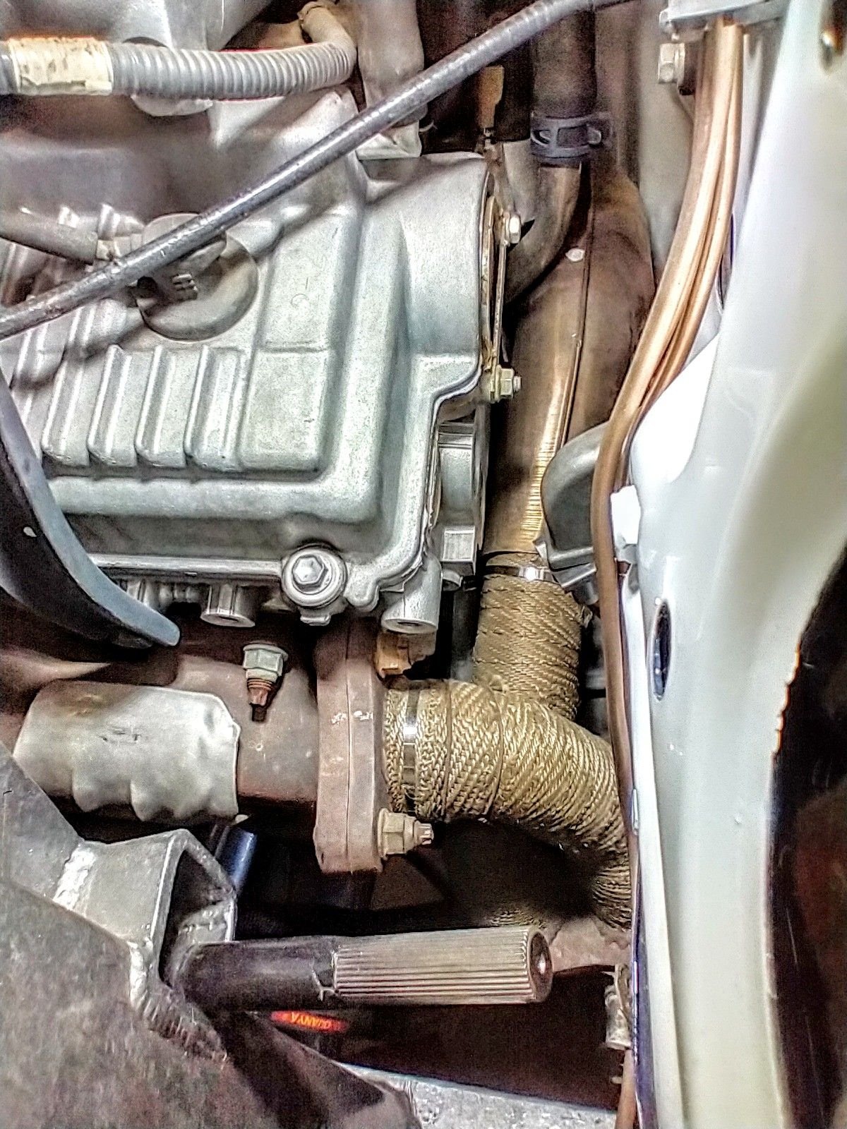

As far as wrapping the exhaust, I wrapped mine back when I did my swap. No rust out issues for me but I live in the desert. I have gotten it wet from water crossings or even washing my engine. I was more concerned about damage from the heat to my wiring and cables as well as a ton of heat into the firewall and floor. I wrapped from where it attaches to the manifolds to my CAT and after my CAT to my muffler. I made heat shields for above the muffler and CAT. I cut up and refit my original cross over and the rest of my exhaust is built from a universal kit of mandrel bends. Just aluminized mild steel. No rust yet. I used DEI header wrap.

I went out in the garage to take a look at my engine. You may just need to reseal your rocker covers for a good start on the oil leaks.
I included pics of my wrapped exhaust just to show you the condition after many years. Only that bottom section has new wrap on it. I had to cut, turn and weld that section. The top is the same stuff I put on back around 2011. You can see I used plain mechanics wire back then. I added the new stainless band recently.

My 88 22RE 3 row brass radiator, 3.4 fan clutch with 3.0 fan and my home built shroud cools it so your larger rad should too.
