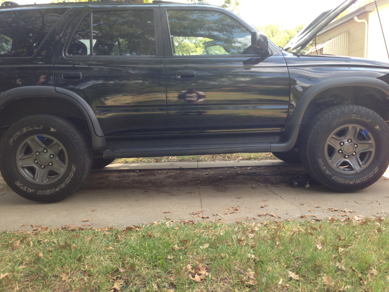

Ok fellas... Jacked up one side, put it in 4wd and spun the rear wheel counter clockwise. I put a piece of blue painters tape at 12oclock on each wheel before spinning. The pic is the end result. The rear wheel back at 12, the front at 1~2.... I would assume that the front would be the stock ratio, but have no idea what that might be. I'm thinking it'd be easier to return the rear to stock vs. swapping the front since I have NO clue what is in the rear at this point.... Anyway, thanks for your help.
Jay

If you spun the rear tire counter clock wise it would have lower gears (higher number) in the rear.
Try your door jam for the axle codes for a start then I would do a spin test on the front axle only.
Figure out 100 percent what you have now so you don't buy the wrong thing.

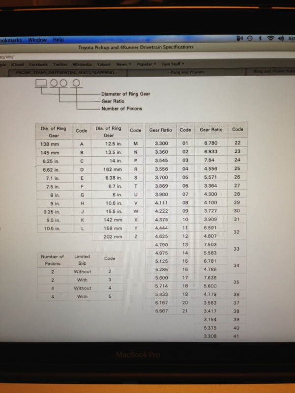

Ok, found an Axle Code table that explained it pretty well, only thing is that I'm not sure what the 'A' at the end of my code means. According to the chart I'm supposed to have a 138mm dia. ring in 3.545. According to the chart I found, the last digit should designate the number of pinions with or with out limited slip. Here's a pic of the code.

Yep you found the chart for the gear codes. On mine I think the last one is for a 4 cylinder or V6 differential. Looks like you have 3.54 gears. Idk if 4runners of that year came with that, Someone will chime in with more info on that.
The spin test as I call it is where you raise the vehicle spin the tire and count the drive shaft revolutions then divide them. You could search how to find gear ratios and it should come up.
