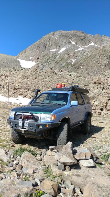

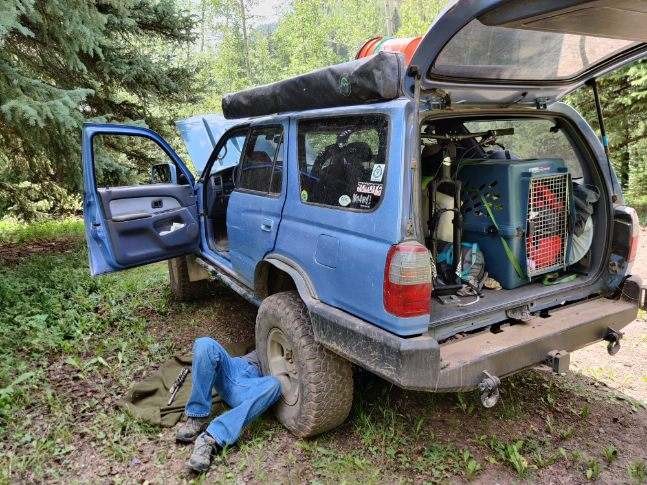

Both my husband and I have their rear bumpers with tire carriers and their front bumpers- we had them do front hitches for our needs, mine has the single hoop and my husband has all the hoops.
What would you like to know/ want a pic of?

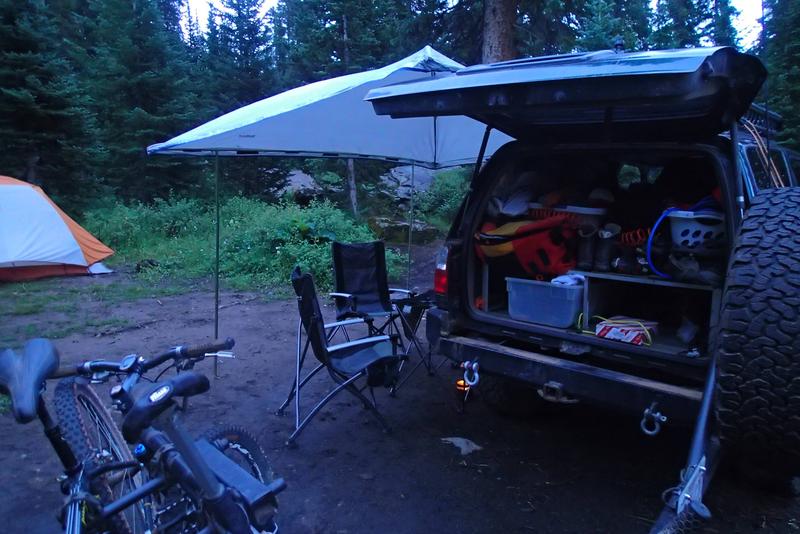

They get used.
