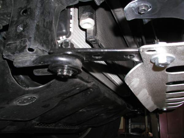

Finally back at it. Here are 3 shots of what I did to add hooks and move the plate forward and upward as well. Bought 10,000lb tow hooks with 2 bolt holes in them, used one bolt to connect to the stock eye, and the other bolt to connect to a 5" long 3/16" thick piece of steel that I ground, drilled, and then painted. The hook can be torqued as tight as you want, and the bracket supporting the skid plate is seperate and above the hook, so they will never interfere with one another...enough typing...here's the pics. Next up is a new custom grill and the addition of the sport edition hood w/ the blower...i'll just let those pics speak for themselves when they arrive. I have just one question: What is the name of the member who is a toyota sales rep here on the forum? I was thinking his name was Tom? Anyway, I was curious if he could beat the $370 price for the hood that I was quoted...late...and 02Runner, thanks for the compliments...I'm no rocket scientist, just some idiot with time and a little money on his hands who likes to screw with his vehicles...gald I can help the rest of you...peace.

and a final side shot showing the brackets, hooks, etc...if anyone could help me on how to get these pics larger for you guys I would in a heartbeat, I tried saving the pics as a webpage like on member suggested, but that didn't fly either...any help in this department would be much appreciated...plus it would allow you all to see the images much better without a magnifying glass...peace.

Old Dec 19, 2003 | 11:09 PM
Nerve's Avatar
Joined: Oct 2003
Posts: 26
From: NYC
Cool pics!
And nice modification on the skid mod (a mod mod?). Gonna have to change your sig now, she ain't stock anymore. Looks good.
Geek alert, but looking at that 2nd pic after seeing the latest LOTR flick, kinda reminds me of that spider with the fangs and such.
Quick question about the mod... Does the skid plate alone take away from any ground clearance or approach angle?
And to answer your question, the Toyota rep is TOR (aka Todd).
Jon
Old Dec 19, 2003 | 11:25 PM
fourunnabilly's Avatar
Guest
Joined: Jun 2003
Posts: 737
From: Last stop on the westcoast line
Nerve-
Thanks for the input. The sig has been that way and will remain. If i listed all of the mods, it would take up an entire thread...just easier that way. Approach and departure angle are unhindered by the plate and the tow hooks, have the 3" revtek on her and went wheeling tonight, no probs at all...and now I have front tow hooks too...
Also, thanks for the confirmation with Todd, I should shoot him an email. The skid plate is still actually higher than the stock setup on both the tundra and tacoma by a couple of inches...not to say that the lift helps. Late.
Billy
