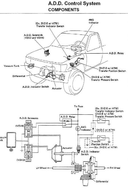

This help?

Originally Posted by kyle_22r
there's a 4wd indicator switch on the transfer case
The switch on the transfer case controls the ADD relay which in turn sends power to either the engage or disengage vacum solenoid, the ones inside the front fender. The vacuum then activates the ADD system. There is another switch on the front diff that senses when 4wd is enagaged and turns on the light. If you look on the front side of the diff you'll find the electrical connection for this.
If 4wd is working and the ADD is engaging then the problem must be the switch on the diff, or the bulb. Try removing the electrical connector from the diff and jumping it with a wire, (on the connector side) , then put it into 4wd and check the light. If the bulb works it should light, if not it's probably the switch.
This is assuming the 4wd is actually engaging, also check the vacuum lines like someone suggested.
