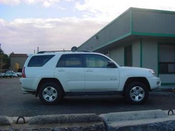

Daystar and NE both have a front only leveling kit. I installed the Daystar 1" spacer approx. 10 days ago. FYI - My rear-end is now approximately 1/4' lower than my front-end as the lift was much greater than 1". I'm having NE send me a 1/2" rear spacer to correct.

mac -- did you get it aligned yet? if not, that will probably be part of the reason for the greater than 1" of lift. also, as we discovered, a 1" thick spacer is going to give you far more than 1" of lift. my spacers measured 2+ inches and yielded over 4.5" of lift. Anthony has worked out all the mathematics of it ... but yeah, adding a 1" spacer will give you more than 1" of lift.
