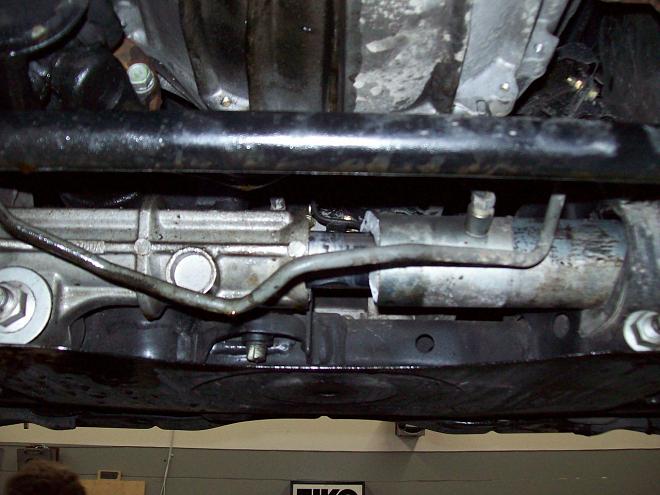

So thought I would show you all my nightmare I have been dealing with over the past week or so. The story goes, it was snowing with snow on the ground. Tree covered in snow was covering up stop sign. I slid through the intersection and hit the curb on the other side. I was at about 10-15 mph on impact of the left front tire. Anyway took it to Gregs Japanese Auto and the damage done was a cracked power stearing rack, bent right tie rod, bent left rim, and way out of allignment. Now the rear end is howling so I took it to Randy's Ring and Pinion and they are going to take a look at it. Possilbly the bearings, not sure yet if it is from the collision. I am running everything through insurance so it has only cost me $500 so far....

With a hit that hard to break the rack,I would inspect that side wheel bearing(bent wheel) as well...

So the carrier bearing in the rear end spun. Guess it was so loose you could pull it out with your fingers.
So I had to replace the whole carrier. The price of a new carrier is $$$ and for only $170 more I upgraded to a Truetrac. Haven't had a chance to try it out, but I know I will like it.
