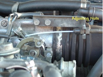

Have you looked at the gas peddle side of the cable? I did when I was looking for a way to adjust it.
There is a red/orange squishy thing that seems to compress on the cable while the peddle is being pressed. I wonder if it would help things to replace that with something more solid?? I was thinking it would allow the peddle to actuate the cable with more response and less slop....but then again - I've already been wrong once today

Originally Posted by ROMAD
Figures :pat:
Nah I never checked that out...but its definately a thought! Thats what we are here for..insight and knowledge! I've learned alot here...

Ok, My 1995 must be setup differently because I just checked things out and here is how my TB cables are setup, when viewing from the front/radiator with the hood open:
Top - back = Goes to cruise control
Top - front = Goes to Automatic Transmission
Bottom = Goes to firewall then to gas peddle
Also, I do have a timing light and I jumped the diag port and then set the timing to 5 deg BTDC ( counter clockwise is advancing the timing ). Took a drive around the block test drive and didn't observe any pinging....after traffic dies down some I'll go hit the freeway and see what happens.

Correct me if i'm wrong...but the green 5-10 is btdc advanced and the red is retarded from tdc. if you are confused on the throttle cable placement then have someone get in the vehicle and press the gas pedal and you will see which one operates it. or just put your fingers up where the cable is and rev the engine that way.

I traced the throttle cable from the throttle body to the gas peddle about 30 mins ago. I dont have a helper but its plain as day to me which cables go where.
Thats from the Factory Service manual showing how to set 10 deg Before Top Dead Center.
YOU'RE RIGHT YOU'RE RIGHT! I'm the dumbass...took a simple thing and turned it into complicated s*&^! Sorry for the misinformation...i just adjusted my bottom cable going into the gas pedal and readjusted my cruise back to where it was. Once again...sorry for the misinformation! Learn something new everyday...
