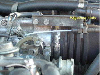

Originally Posted by callmej75
did you try the throttle cable adjustment mod?

Well, I don't have a digital camera (switched over to film), so I cannot take a pic of my TB. I cannot locate these screws you are referring to. Here is my best verbal description of the throttle body on my 94 pickup: throttle cable comes from cab over top of intake manifold, the jacket terminates at a bracket thats mounted to the intake manifold, the jacket has a threaded metal piece for about 1.5 inches at the end, two nuts threaded onto this sandwich the bracket and hold the jacket in place, after the threaded part the cable exits the jacket and is anchored to the rotating linkage part with a lead fishing weight looking thing. Are those two nuts the things that you are talking about?? Because other than that, all the other adjustment screws only adjust things at idle, like the throttle stop screw, and the two other screws that strike those piston looking things (one has a vacuum line going to it). There is also the idle adjustment screw, but that's not even close to all the throttle linkages.
BTW, this doesn't matter for me, because I had my gf sit in the truck and press the throttle all the way and it smacks the TB fully open (the part that is cast into the TB to stop the butterfly from rotating any farther [on the outside]). So my cable isn't stretched at all. Just trying to clarify for other people.

I'll get a crappy cell phone pic tomorrow. Being a professional photographer, be rest assured I will spend way too much time getting the lighting right and making sure it's as sharp as possible, lol.
