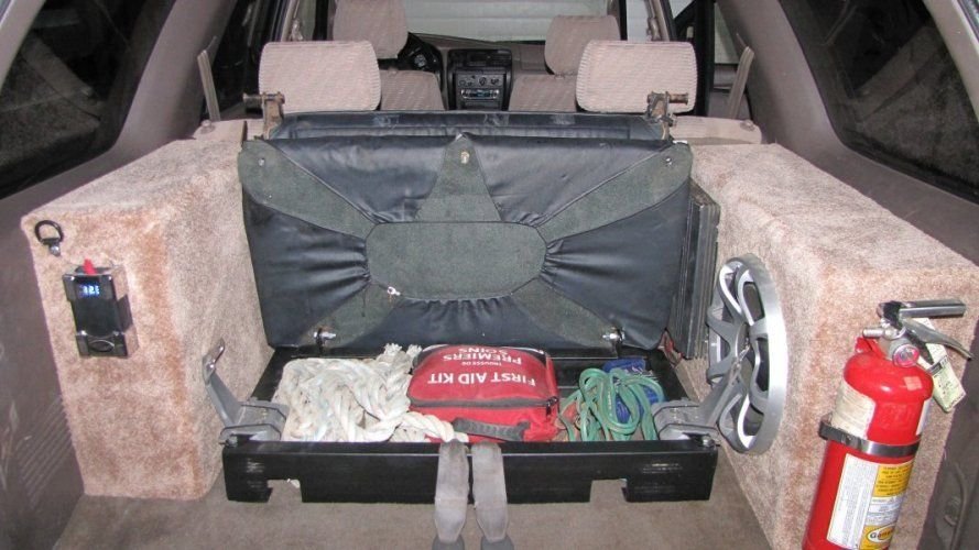

After months of planning and reorganizing the rear cargo area, I finally have enough seats for the whole family. First, I had to move the subwoofer from behind the rear seat and design a new box for it over the passenger side wheel well. Then I wanted a spot for the second battery and power-block so I made a box for that over the rear wheel well on the driver's side (the top of the box is hinged for access to the batt and cables).
From there I needed a seat to fit in between and found a wrecked Jeep YJ rear seat which fit in perfectly plus it was a fold and tumble forward design so that worked out geat too. Then I made up a mounting base out of 4" "C" channel steel so that I can store various stuff under the seat.
Here's some other positions:
I also opened up 2 spots in the rear of the base to accomodate the portable winch's reciever end so that it now just slides in and sits there securely without it sliding around the back when I'm climbing up steep hills etc.
So what do you think?

dang looks good. how did you secure the base down?

Looks good. Any rear end sag with all the weight back there?
I just bought some Airlift bags... maybe you'll need to do that too

wuts holding the square seat mount down is it easily remove able? I would like to do this kinda thing, except i would like to make it removable seeing as how i haul alot of stuff.

^99runner^ how did you secure the base down?
6 bolts through the floor backed with extra reinforcing to prevent any pull through in case of an accident.
^BajaRunner^ Any rear end sag with all the weight back there?
Nope, not too much. Actually, I wanted it to drop more as she sits pretty high compared to the front as it was with the lift I have.
The seat is kind of ugly I agree and I'm keeping my eyes out for a nicer one from a YJ that also has headrests this time (not sure if they come with them or not though).

When you built the boxes in the back, are they square around the wheel well or did you curve the MDF?? I am ready to start this project on my truck and what you have is perfect!! I will need to make a few changes, but I am still trying to figure out how to deal with the wheel well....
did you take pictures of the fab?

Nope, no pics of the box builds but what I did was basically "45 degree" around the wheel wells.
