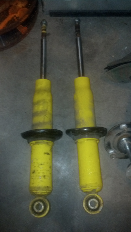

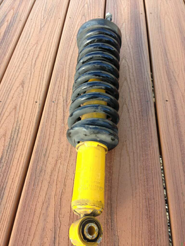

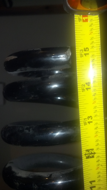

Thanks people, but I got a set of free OME coils/struts from a my friends 06 Tundra. He doesn't know what # springs they are, but the free height is 15.25"s which is a 882/883 coil. Found out the N91S shocks were dead so going to get the 5100 billys.
