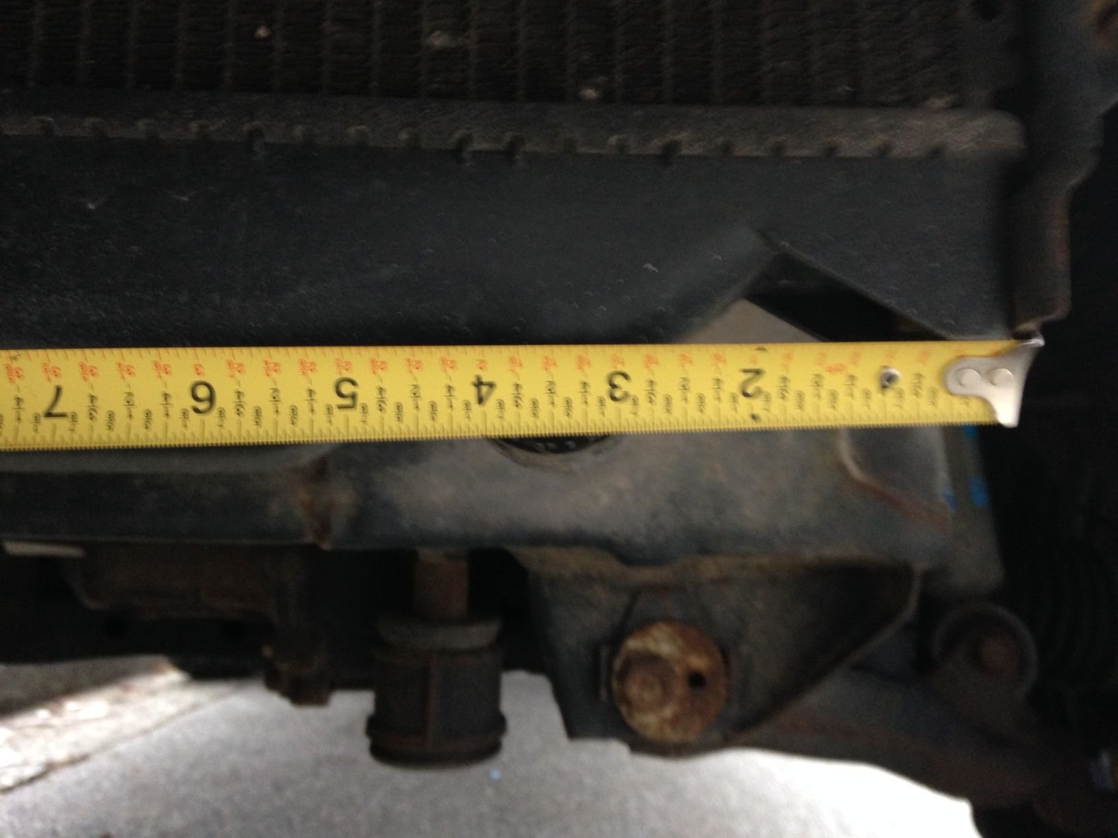

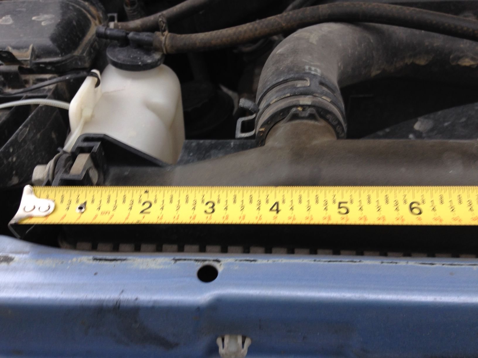

5VZ-FE auto trans radiator height (top to bottom of side steel brackets) is 26in. Width is also 26in. Hangs about 2 1/2in below cross member. I've shown where the main hoses connect as well. Would be great to know the dimensions of the 3VZ rad (or any other slightly shorter rad that fits the other dimensions).
