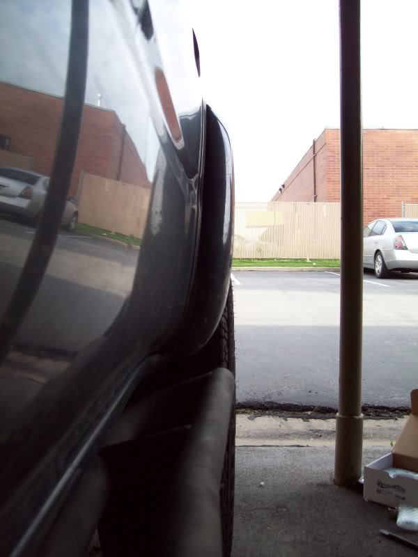

I have the taco wheels and I like them but they look terrible without spacers if you have limited flares. Couldn't find pictures of before I added spacers.

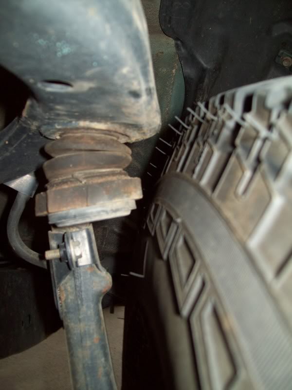

trd 4runnin11 what size spacer are you running??
I have some rubbing going on with mine not alot but it does rub,
This shows where the UCA and the tire is rubbing at

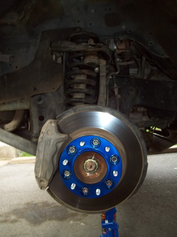

A little update on the rim thing since I had some rubbing issues with the UCA. A set of spider-trax spacers solved that problem.
Spent about 1.5 hrs tonight get the spacers put on all 4 corners (front and back). If anyone ever wants to have a good laugh come by my place and watch a 125 lb kid try to put a wheel back on.
Any how here are a few more photos
Drivers side UCA clearance before

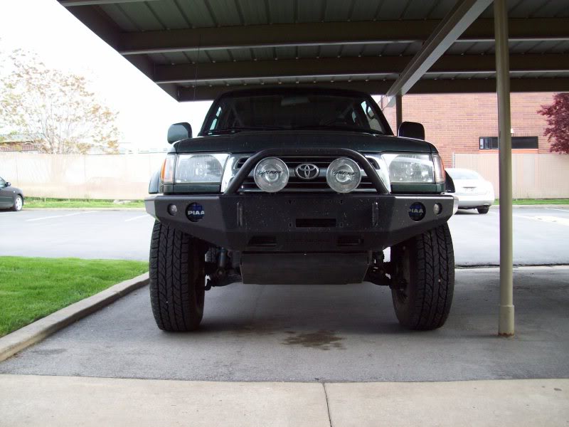

Front view before

Front view after

Rear view before (passenger side, forgot to photo the drivers side before but you get te idead)

Took it out for a test driver after and the rubbing noise is gone and I haven't noticed any weird vibrations. Steering feels a little more normal as well.
I have plenty of lock-tite on the studs and on the nuts.
