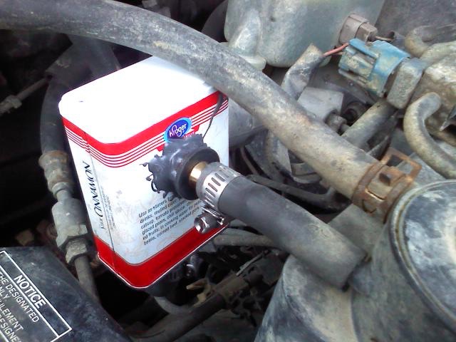

I am new to this thread and this is my first post. The following will explain the reasoning for the buzzing sound coming from the evap canisiter on third gen 4runners after engine shutdown. Sometimes after shutting off the engine to these thirs gen 4runners there seems to be a buzzing noise coming from the evap canister. The reason this happens is because of the canister processing the gasses is not big enough to handle to amount of gas being pushed through. Along with this, the vacuum hose connected to the exit of the canister is too small for the amount of pressure from vapors being exited. The simple fix for this is to simple make the canister that the gasses enter bigger than it is. This is easily done from just taking another air tight canisiter and connecting it after the stock canister. This will allow for all of the gas to enter and not create a buzzing sound through the tube without buzzing the valve. Following are the pictures showing the procedure conducted that solved the problem perfectly without that annoying buzzing sound reoccuring.

Yer a little slow on the draw, but nice first post. You must also have an early 3rd gen, the later ones don't moo.
Welcome to yotatech, always nice to see someone coming up with cheap fixes and sharing them. Keep up the good work.
From a couple of years ago....I'm partial to mustard, makes the old gal zippy, and maybe the truck, too.

Thanks for the advice. But personally, I think the cinnamon just makes it more of a "sweet" ride 😂
