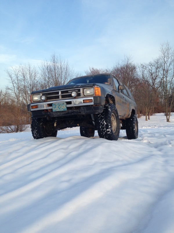

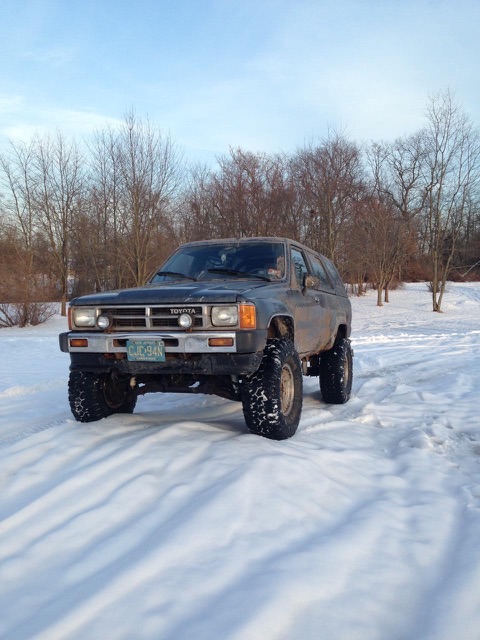

i have 33x12.5 tires mounted on my stock alloy rims, theyre only 7 wides and i have no problems at all as far as center wear or anything. The only trouble i had with them is balancing them was a bitch but now they ride perfect and have no problems whatsoever even at highway speeds
Attached Thumbnails are 33x12.50's too big for a 8" rim?-img_3373.jpg   are 33x12.50's too big for a 8" rim?-img_3374.jpg   are 33x12.50's too big for a 8" rim?-img_3370.jpg
