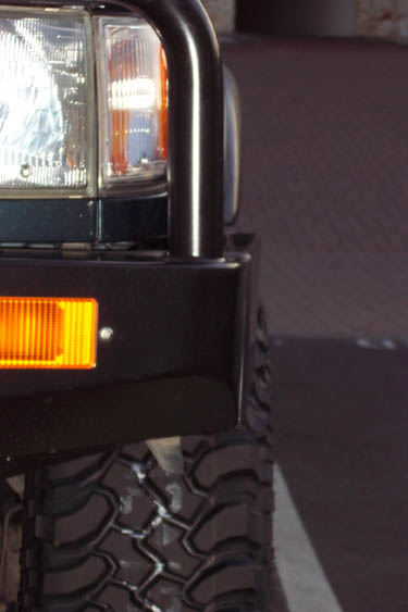

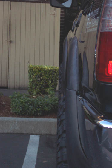

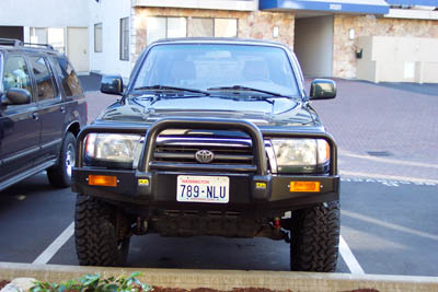

Man, I don't know. I'm getting enough rubbing as it is with 285's. I've done the BFH mod, so mostly I just notice it offroad during turning and stuffing at the same time. 285's are pretty wide as it is:
https://www.yotatech.com/attachment....&postid=128751
https://www.yotatech.com/attachment....&postid=128738
https://www.yotatech.com/attachment....&postid=128750
With the stock SR5 fender flares, its nice offroad because I can see where my tires are going, but I get a ton of schlit sprayed up on the sides of my vehicle and the paint chips to prove it.
