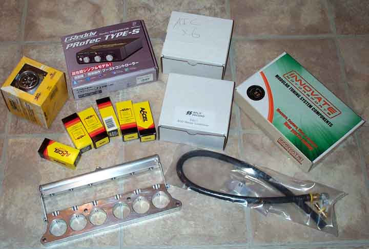

Fuelin and Boostin Stuff Arrived!!
Everything arrived from URD and others today to finish this project! Here is what I purchased:
URD Port Fueler with 6 injector controller
6 - 30lb additional injectors
Greddy Electronic Boost Controller
Innovative LC-1 / XD-1 Standalone A/F kit
Split Second ESC1 - 02 signal conditioner
Autometer Carbon Fiber Boost Gauge (30hg vacuum - 20lbs boost)
All this will be going in this week! DYNO Day coming soon!!!
PIC of new stuff below:
