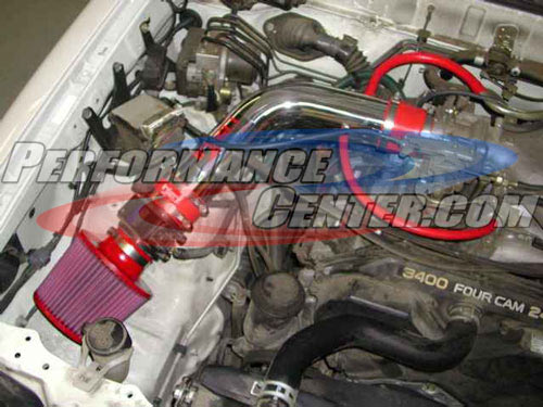

Oh and another potential issue: Also when the engine is at operating temp the "cold-air" intake is almost too hot to touch. I have the InJen intake system as seen here: I got a good deal on a used one and opted to use an aftermarket model because the OEM intake did not fit in my 4Runner.
Yeup... I've said it many times here, those "cold air" boxes are worthless. The "cold air" would last maybe 10 minutes under my hood.
The only valid cold air intake I've seen on our rigs is one where a guy grafted an intake to fit into the space between the bumper and the headlight. There's an old thread around here somewhere.
