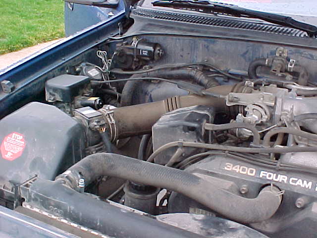

i am real curious f this silencer removal mod can be performed on a t100 with the 3.4 L , any other info about this is found in this forum somehwere isnt it ?

Hey, take a look at the ISR Mod Article. It is several pages long, so be sure to read all of it. The intake tubing is bound to be similar enough so that you can adapt the mod to your needs. I'd be willing to bet the intake tubing on yours is going to be the same as the 96-98 4Runners or the Tacos.

dr. z
i think my set up is the same as the 96 to 98 set up you have listed . im going to read your article some more and see for sure
is there any dis advatages to this mod ? lower gas milage ? chance of it breaking down ?
erik b of oregon
