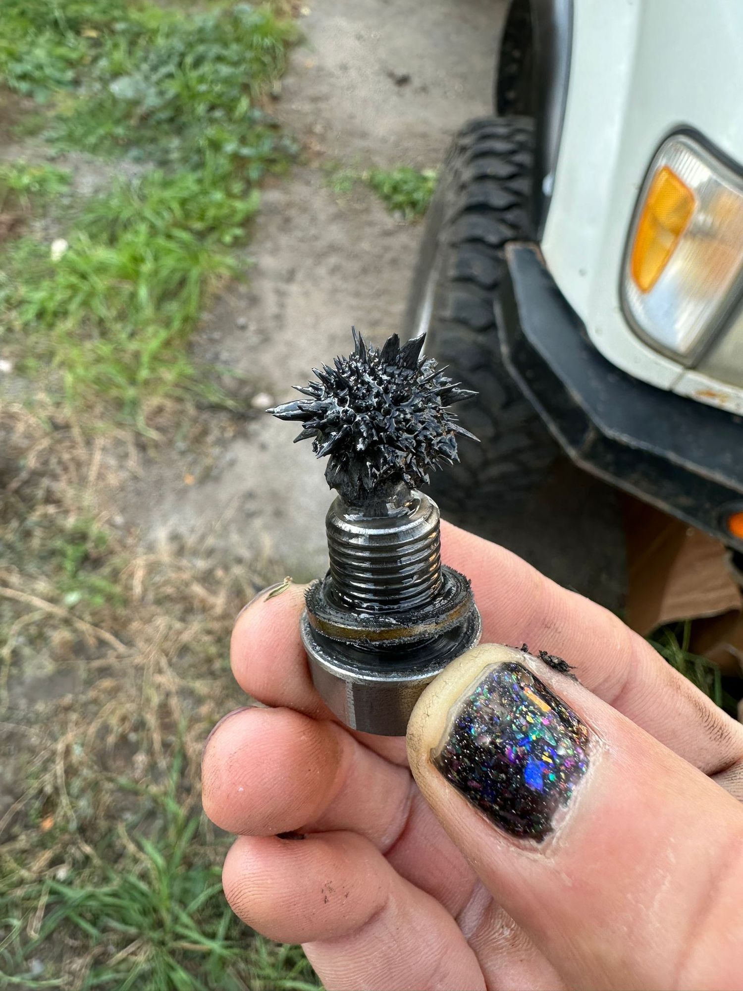

After the job was finished I reassembled the engine and after driving it did not produce codes but started to have engine noise.
Noticed that on the drain plug for the oil pan it had metal but no flakes it is a very fine material almost like sludge. Greyish color.
I thought it was the supercharger rotors (as it sounds like supercharger rattle and was originating from top end / valve cover area)
So I had the supercharger sent to Jon Bond in Iowa (came recommended) and had it fully rebuilt. The S/C was in poor condition.
As per their inspection:
-Significant rotor wear / ceramic coating is missing
-Back bearings in S/C had worn needle bearings which were "throwing grease"
They rebuilt supercharger and ceramic coated the rotors shipped it back to me.
I reinstalled the S/C on the truck today and the engine noise has still not gone away.
Any idea what it could be? Video link below
EDIT : Truck does not leak oil / burn oil and checked for blow by (oil cap on loose) does not indicate ring wear...
