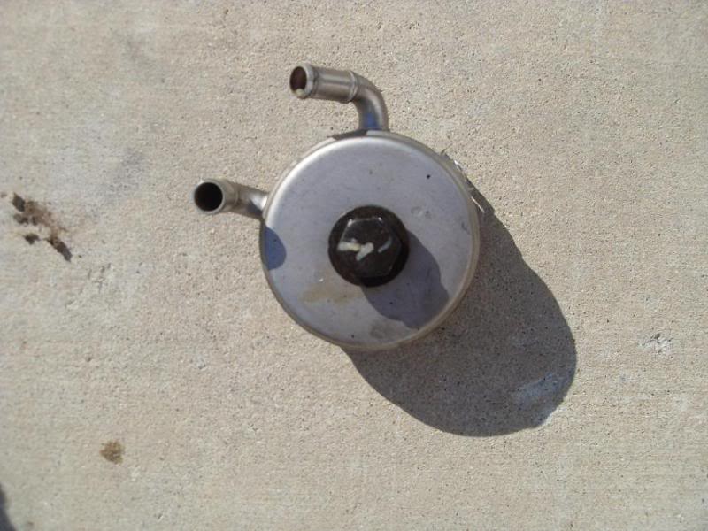

No, it goes to an engine oil cooler on the block. The auto transmission fluid cooler is inside the radiator.
My 5-speed has the outlet tube on the WP. You should be able to see the cooler about two feet to the rear of the oil filter on the driver's side of the block. Look from underneath. It looks like this:
