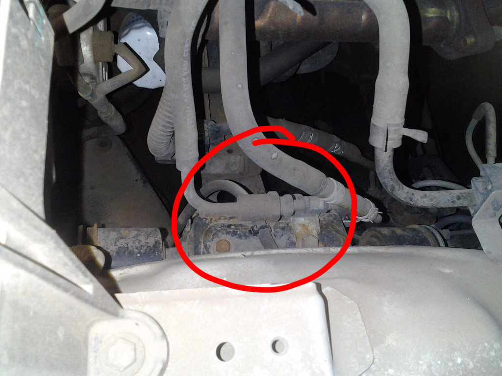

Like I said, your gonna have to t into the system with a fuel pressure gauge. I think the easiest place would be the coupling between the soft line and the hard line on the drivers inner fender right below the brake master cylinder.
This is a 3.4 tundra, but the coupling should be the same. I circled it I red.
