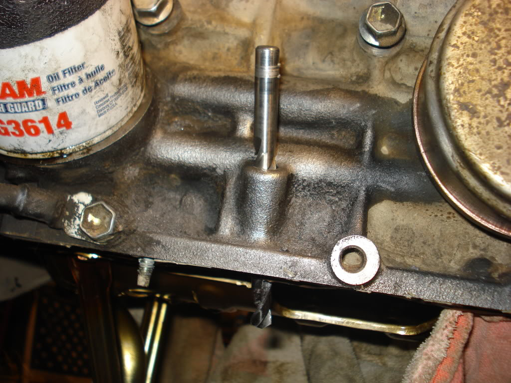

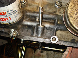

Near the oil filter

Old Mar 10, 2019 | 08:15 AM
habanero's Avatar
Joined: Sep 2005
Posts: 8,247
Likes: 497
From: mo
Dunno if this is in any way helpful...
Where your dipstick tube receptacle is does appear to also be on my motor but without diving too deep does appear to be plugged with something. You may be able to find the hole for the 4wd as illustrated below-
96 3.4 4wd if it helps any- you're right about different location, though not far from there. This is just copy/pasta'd from my build thread, comments can be ignored-
Here's where it goes:
Pointing to it:
Carefully push into hole until bracket lines up with screw hole. It should be a little bit harder to get in because shiny new o-ring! That's the bottom of the lower radiator hose at the top of the pic.
Like I said, way longer to document than to do, it's a 5 minute job and that's including grabbing the 10mm socket and ratchet, a rag and a little screwdriver to scrape the icky dirty stuff away from the tube.
-and-
Also, while I had it apart I measured how far the dipstick extended below the tube, in centimeters:
and a close-up of the measurement:
Sometimes this question is asked, usually having to do with an aftermarket replacement dipstick. Now it can be answered!
