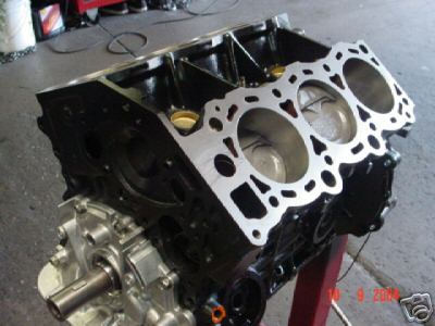

Does anyone have pictures of a 3vz-e block without the heads? That way I can go and check when I pull the fe heads to see if they bolt up before buying them. DOA told me they wouldn't, but dan seemed certain they would. If I had a pics I could be pretty sure before buying them,

I dont know how helpful these will be but they were found on ebay....
Attached Thumbnails 3.0 with 3.4 power?  Build up in progress - donations needed!!-3vze-short-block3.jpg   3.0 with 3.4 power?  Build up in progress - donations needed!!-3vze-short-block.jpg   3.0 with 3.4 power?  Build up in progress - donations needed!!-3vze-heads.jpg

I saw those too I also found a gasket set for the 3vz-fe and it looks like at the holes on the gasket set match of the -e block. Also I found a 3vz-fe for sale online for 750 w/free shipping. That may be cheaper than buy all the bits and pieces. Use what I need, part out the rest. Most places here in texas are selling the heads fro 125 a piece. I could use the motor, steal the heads and pistons, sell the block and other components I don't need to a junkyard. The motor is a much great one time outlay thought. Going home the weekend after next. Going to try and sell my 3vz-e intake parts and pick up a 7mge afm, 7mge injects, and 3vz-fe heads if I can.
