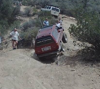

For $75 you can get a 4Crawler bodylift, I would advise an inch. Then add $70 for front air shocks. Another $70 for new rear shocks and $20 for Cruiser coils plus $40 for a panhard drop bracket. Around $300 for brakelines, rivets, etc you can have adequate room for 33's, keep a low COG and wheel it like a bugger.
I chose the latter.
[/elitest gearhead]
Looks like this.
