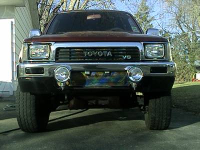

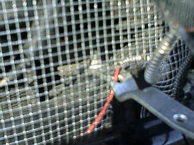

Another alternative, Ive got a 91, but it might be the same. Look behind your lower valence. Just behind it..i think its the radiator core support you could, fabricate some mounts and have your lights come out infront of your valence. I did this with mine and mounted some KC's. I think those are fairly larger than hellas.
Toyminator_-_You have any pics of that? ! ? At one point I was thinking of doing that, but keeping the lights flush with the valence and cutting a section of the ribs out, so there was nothing to block the light.

I dont have any pics of it...but i just washed my runner yesterday. So i was planning on it soon. I will do it today. Ill be sure to post them. As far as putting them behind. I tried fitting them.. but i saw it would be hard to adjust from back there, and KC's are 5in. deep..so they wouldnt fit.

HEres the pics, i got it to work..i hope this is the right size. Front view

Resized front.

Mount and light

BLurry mounting to radiator core support.

Hope the pics help. Give me your response.

Looks good man. Think I might give that a try, or a variation thereof. So do those hold up pretty well? any vibrations? other problems?

The mounts hold up good...I went to home depot...the only thing i could find were shelving brackets. They were in the shape of an "L" ....i found the thickest ones i could find..i straitend them out..and viola. Theyre pretty sturdy....just dont rear end someone.
Im not worried abit about them coming unalligned or needing any tweaking. They do flutter
a bit..but its nothing major. Im prolly going to find some where to put some rubber stops somewhere.
As far as the corners go...i painted them with spray paint. It was spray paint for Lexan Rc car bodies. Its more flexible than regular paint...thus no chipping! Dats about it.
