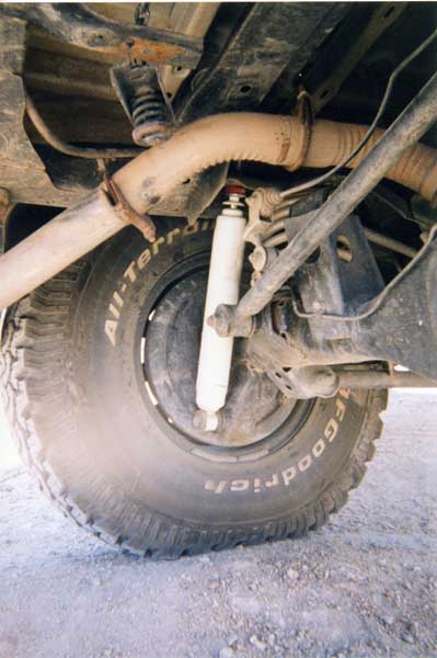

I just got a new set of Rancho RSX Shocks and put them on, I got some pretty respectable articulation out of the back.
Now all I need is low profile bump stops up front for more stuff and droop, and a way to keep my driveshaft from hitting my gas tank...
Anyone else have good pics of a 2nd gen articulating with IFS? What about a line on an inexpensive drop bracket for the trailing arm on the backside of the axle so I don't hit my gas tank?

The ones I got are sweeet, they are about 5" longer than stock extended and onjly like half an inch longer compressed... Conclusion, acceptable articulation on an otherwise stock rear end.
The 33" tire actually drops about a half inch under the body, not too shabby, and on the other side stuffs into the fender almost past the sidewall tread.
I got more pictures, like my spring trying to escape, and the drivers side shock completely compressed.
You can also see my rear swaybar begging for mercy, i may have bent it beyond repair that day... Time to take it off.

The other picture...

Probably shocks similar to mine are good, I could give you part numbers if you want but your best bet is to look at the rancho shock absorber application chart on gorancho.com. My shocks are 25.250" long or somethiong like that, you might find simliar appliactions in the 5000 series shocks, RSX is kind of limited... I just drilled out the bushings on the bottom to make them fit, and went from there. Worked like a charm. The wider tires may have trouble getting by your fender lip though, I only have 10.50's.

The drop bracket for the pan hard bar is important because if you lift without it it will begin to pull your axle towards the passenger side. This isn't a problem until you get longer shocks, because now my drive shaft will hit the gas tank when I stuff my passenger side and droop the drivers side.
I have the Downey 1.5" HD Springs in back, but the HD makes them lift the back end a little more, hence the 2.5"... I plan on getting the spring spacers later on also. If you get the springs I have, you will need to crank your torsion bars a little, otherwise your rear end will be taller than the front. Even with stock cranked torsion bars, the ride is pretty soft, I wouldn't worry about a little cranking.
