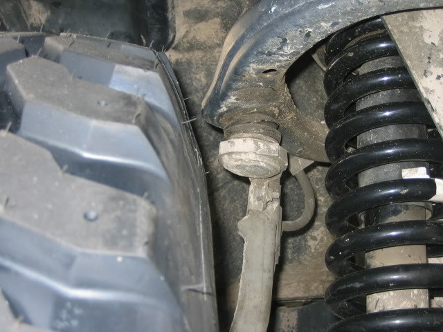

I've never aired down to 10 psi on stock rims...too chicken lol. I have been down to 15 through. Here's an upper a arm clearance pic with my 285's on stock 16x7 5 star rims.

I have a '99 Limited with 881's w top out extended spacer and 891's. I want to continue running the 16x7 15mm offset 5star rims with my new set of 285/75/16 BF AT but having rubbing issues (so says the tire shop) so I just ordered 1.25" bolt on spacers to bring it to -17mm offset.
was that the right move or could I have gone w 1/4" spacers. I dont want any rubbing, I do do alot of highway driving. what are your thoughts? thanks.
