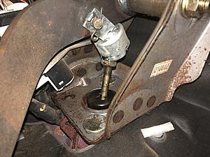

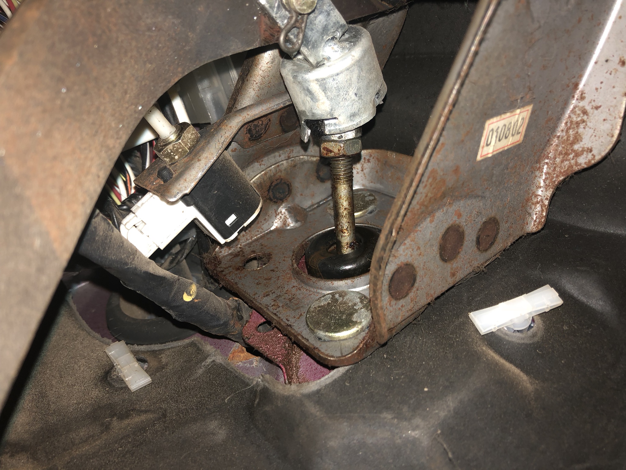

What I found was under the dash, where the master cylinder plunger connects to the pedal, it looks like in forcing the pedal down I folded where the pliunger connects to the pedal (pic attached). So, something was freezing the system up and I forced it bending that connection. My concern is what would be binding everything up? I wouldn't think it could be the master cylinder could it. \

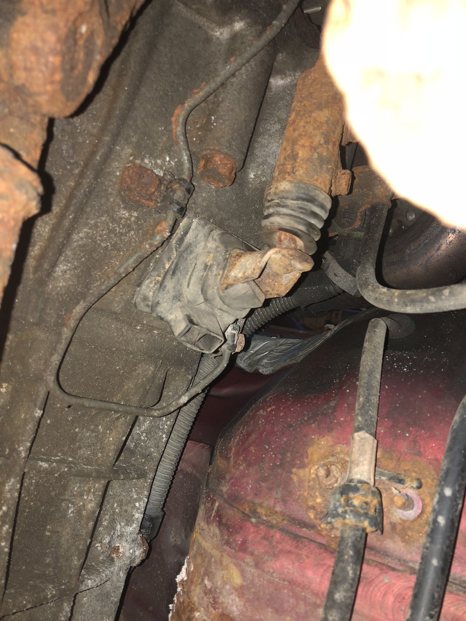

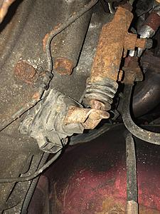

So, I then went under the truck where the slave cylinder pushes the throw out bearing lever and tried to see if I could move that at all to see if it was set up. I couldn't budge it. I assume the pressure is too much to push my hand. I hand a small pry bar but nothing really to get leverage against to give it a good push. In good working condition can this lever be moved by anything other than the slave cylinder for testing purposes? I'm hoping something didn't break inside the actual clutch assembly.

Here’s what my linkage looks like for reference, in case it helps.

I gotta wonder did the clutch release bearing get off center on the transmission front shaft and bind .
Might be the fork is slightly bent as well
Making things give at the weakest spot when applying force to the pedal .

I didn't get back to the truck for a while but removed the slave cylinder to find it pretty much junk and rusted pretty bad. I'm leading to believe this was my problem and am planning on replaced this and the master cylinder in the next couple weeks.
