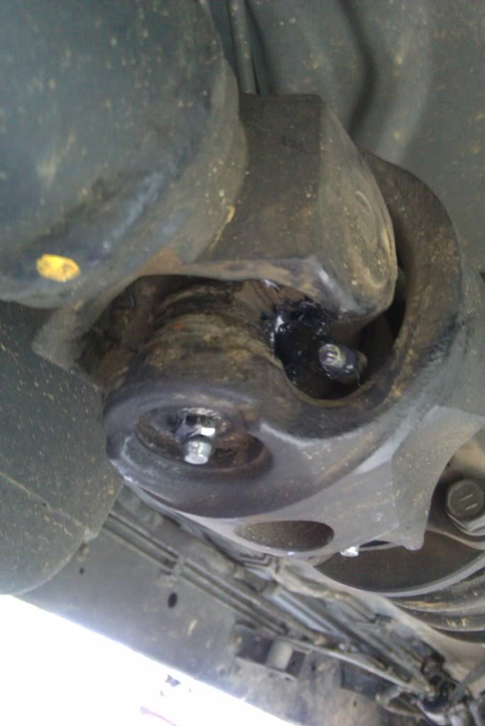

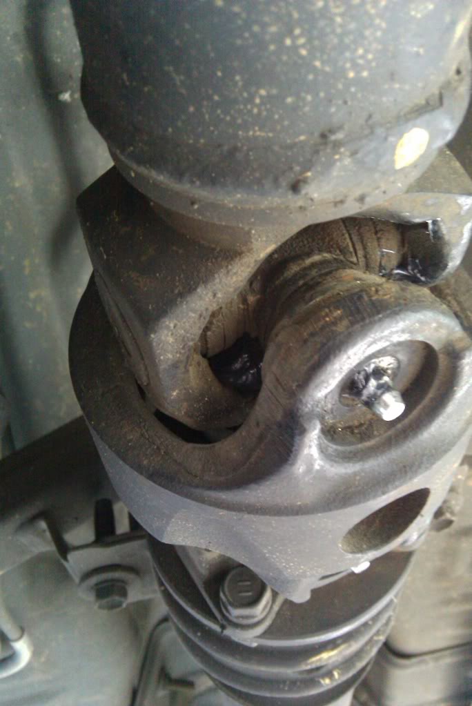

Ok, read through the thread and lubed all of the fittings I could find (9 total; for a '98 Taco V6 4x4)
While greasing one of the fittings in the center bearing (I believe the double cardan joint), it seems it wouldn't take any grease.
For all of the other fittings, I could add grease slowly until hearing the hiss / crackle the joint makes when it is full.
For this fitting, though, I pumped a few pumps of grease and felt no resistance, then realized all the grease was coming out of the other side.
Does this indicate a bad joint? If so, what indication will it give before failing?
Here's a couple pics to show the fitting in question and all the grease that I pumped in there:
It's the fitting in the middle; the one that's angled towards the driveline
Here's a picture of all the grease in the center of the joint
Old Mar 10, 2010 | 08:20 AM
  #38
MoMatt's Avatar
Joined: Feb 2010
Posts: 5
From: Buck Owen's backyard
The chirping has gone away after lubing the driveline. Anyone know why this joint would leak grease and what it means for the future of the center joint / driveshaft?
Sorry for threadjacking, I just didn't want to start a new thread on this.
