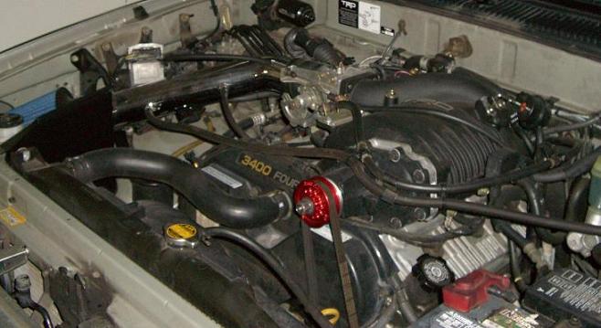

The Walbro pump and the pulley went in yesterday. The difference is not as dramatic as going from stock to the 2.2" pulley, but it is definitely noticeable. I'd say at least 15 crank hp. No audible ping, no codes thrown thus far.

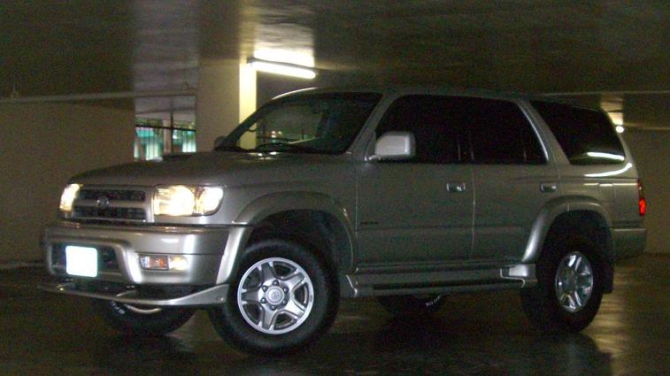

i wanna see pics of the front lip spoiler on ur 00" sport.
Old Jan 8, 2007 | 12:55 AM
QSVeilside's Avatar
Joined: Sep 2003
Posts: 378
Attached Thumbnails 2.1" supercharger pulley installed-2000-sport.jpg   2.1" supercharger pulley installed-reverse.jpg
